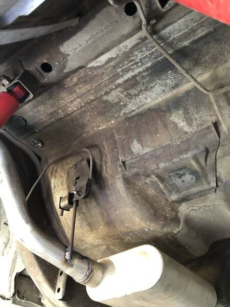

I presently have the rear end housing out to replace it so I have a lot of room due to car being up on stands. I can get at the sending unit pretty easily, any suggestions as to what to look for as far as a brand?

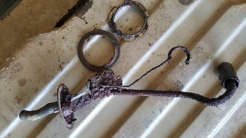

Yes, it is not too hard to do under the car. However, I currently have the tank out of my 64 Fury, and am replacing everything including the tank. The pic shows how crudded up stuff was in my original sender...

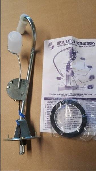

I bought a Spectra FG129A unit from Rockauto. It is shaped different at the pickup tube, and the float swing arm is much shorter than the original unit. So, I am hoping the gauge will work properly, but not confident yet. I ran into a problem with the new filler tube grommet, and finally received a different on this week. But have not had time to replace it yet, so no tank in car yet...

I bought a Quanta aka Spectra. Works great four years now.

Here's my old one!
Hard to believe your tank was useable given the condition of that sending unit.
Wow that was hammered.

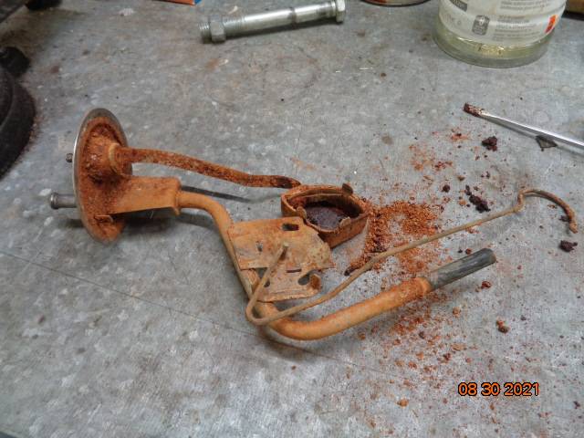

I installed my sending unit today and found the reason for not working was a float full of gas. I removed the float and shook it and you could hear the gas sloshing around inside it as well as leaking through a pin hole l, the mesh of the sock was also missing. I feel the tank and sending unit had been changed at some point, the tank is in very nice shape and other than the quoted issues so was the sending unit. I did not have to drop the tank to change the sending unit and the job took about 20 minutes.
