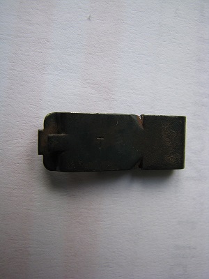

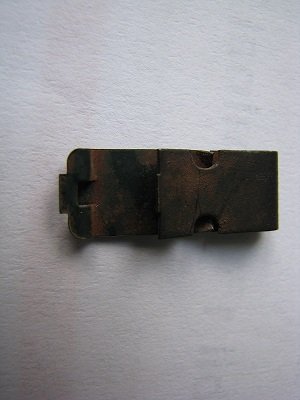

I was cleaning the Charger inside a 004.JPG006.JPG007.JPGnd I found this clip on the floor.
Anybody knows were this clip goes.
Thanks.
Thanks...
How this clip goes on the defroster hose,
There are 2 on each end of each tube. You should be able to see how the others attach.
Thanks,
Tomorrow I will check the defroster hoses and return the clip to original location.
I really appreciate you guys.
strokie
That looks like it might be a clip that holds the cable to the heater box.
On my 67 belvedere there was one of those clips on each of the two hard heater box outlet spouts for the defroster hoses.
