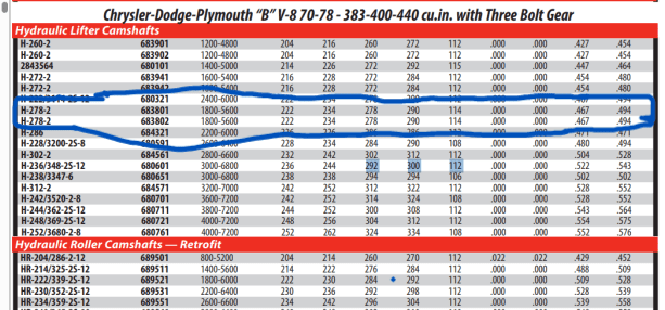

This is the catalog link.
https://www.hotrodders.com/attachments/crane-cams-master-catalog-v2b-pdf.622892/
Here is a little more info I'm digging up. https://www.cranecams.com.au/pdfs/masterlisting.pdf looks to be an older catalog.
HMV HMV Hydraulic series intended for mid-range torque and street use, also fuel economy. Designed to make maximum use of .842” diameter tappets.
Maybe I'm missing something but I can't find the cam in those catalogs.
Thanks. It looks pretty mild.
But based on numbers, seems to be a good small step over the Magnum. Good replacement option for it if you ask me.
