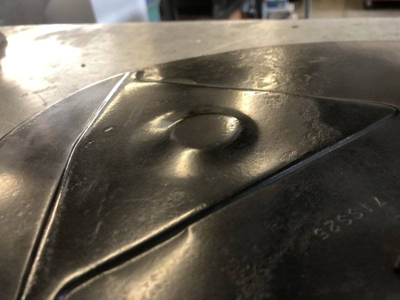

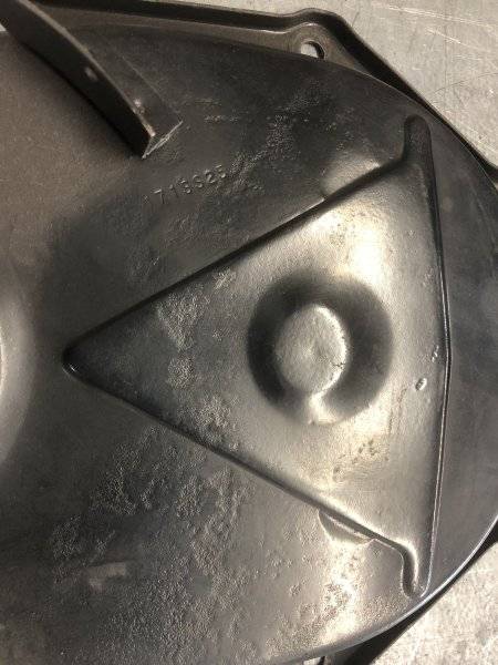

I may buy a reinforced timing cover or weld a plate over mine. That makes sense.
