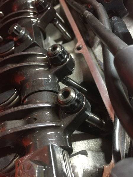

Ok engine builders - Can you help me understand how this happened so I can keep it from happening again? I hadn't run the car in about a month and a half. I started it up in the driveway, warmed up for a minute and drove about a mile to the freeway on ramp. I got on the freeway and everything seemed fine. I'm in California so it was about 70 degrees out - the one good thing still remaining about California. I didn't romp on it and was never over 2,500 rpm (3.55 rear end with a gear vendors overdrive). When I got off the freeway 3 miles later I heard a pretty bad rattle from the engine. Enough that I pulled over at the Starbucks and had the car towed home on a flatbed. It sounded scary. When I pulled off the valve cover I found what you see in the picture. The pushrod is out of the rocker-adjuster "cup" and was just banging around under the arm of the lifter. That's the passenger side, front cylinder, second valve back. If I remember right that's cylinder number two, intake valve??
The engine is a 493 stroker built on a stock 440 block
Out-of-the-box Edelbrock Performer RPM heads
Crower Hydraulic Roller Lifters
Comp Cams Pro Magnum Roller Rockers
Custom length pushrods (can't remember the name of the company, but it's a good one)
Crower custom cam
The car is a street car with about 1,500 miles on this engine build. The cam is "lopey" but otherwise not particularly radical.
I disassembled the rocker assembly enough to get the pushrod out and it's straight as can be - at least it rolls perfectly on a granite countertop. I put it all back together and set the adjuster in exactly the same position as it is in the photo. And the car runs (at idle and up to 2,00 rpm in my garage) perfectly.
I'm NOT an engine builder...
What happened?
If it's not the cam, not the rocker, not the push rod, then...
I have seen that happen even with solid roller cam.In your case me thinks a lifter didn't pump back up fast enough leaving enough for the PR to fall out.Did your oil light come on?? I,ve seen that happen and the lifter came out and lost OP:eek:
I have seen that happen even with solid roller cam.In your case me things a lifter didn't pump back up fast enough leaving enough for the PR to fall out.Did your oil light come on?? I,ve seen that happen and the lifter came out and lost OP:eek:
Wow! That wouldn't be good. I have Dakota Digital gauges and the Oil Pressure flashes if it goes too low. I didn't notice that but anything is possible. The car usually runs pretty high oil pressure - in the 60+ psi range. Hoping that I don't have a failing lifter, but the collapsed lifter seems like the only sensible explanation. It's working now though...
My bet is on the lifter. It was likely pushing on a valve the last time you shut down the engine. Eventually it bled down from the valve spring pushing against it. The next time you ran it r the lifter was bled down and you had a bunch of slack. That would cause the pushrod to fall out.
You guys know way more about this than I do, but wouldn't the pushrod have fallen out immediately when the engine started? It seems weird that the engine ran well for about 10 minutes and THEN the pushrod fell out. Maybe the collapsed lifter wasn't an issue until I got up to higher RPM?
The picture shows about 2 threads showing above the locking nut. That is correct and what you should have. Without a teardown, it is hard to diagnose 100%. I know you want to know the cause because stuff like this will affect your confidence about driving the car, right? If stuff just randomly fails, it makes a man want to drive a new car.

Not familiar with hydraulic rollers, but that said...how much lifter pre-load? Still would believe it would be needed on those. If not enough, get slop in the valve train, especially with aluminum heads, since they 'grow' when warm.
Second, though from the photo, looks okay, rocker angles. From rocker arm to push rod, at 50% lift, should be 90 degrees. Is it good?

I'd say the pushrod - lifter angle is near perfect. Every lifter on that side rotates roughly right through "center", at the 90 degree mark. The cam is a .582 lift, with a 1.5 ratio rocker. That should mean the pushrod moves .582"/1.5", .388", or roughly half of that from "center". That's less than a half an inch of total vertical movement of the pushrod, and it looks like it is doing exactly that.
They ARE in fact ball/ball pushrods - balls on each end. My builder said (I think) there is .400 or four hundred thousandths, which is more than 3/8", so that is WAY more than enough for the ball to fall out. Did he say/mean .040 or 40 thousandths? The lifter is a Crower 66341. The cup on the rocker-adjuster is very shallow, maybe in the range of 1/16".
Maybe just me, but the adjuster cup sounds too shallow. Don't know if you have any choices on the adjusters, so a deeper cup could be used. At least, with the adjusters, you can set the pre-load, as you want it.
After discussions with a couple of mechanic buddies and a really good Youtube video I went ahead and checked the lash on every rocker on the engine. Many of the pushrods were pretty loose with the lifter on the base of the cam. Everyone agrees that a pushrod should not be loose on the base of the cam (valve closed) on a hydraulic lifter motor. Some of mine were so loose that not only were the pushrods able to spin but they had a small amount of vertical play in many cases. The video suggests they shouldn't even spin.
I also read the Comp Cams Pro Magnum Rocker instructions (read the instructions if you can believe that) which say that they are looking for 0 lash plus a half turn. So I figured that 0 lash WITHOUT that half a turn of preload was certainly safe enough for me to get the engine running smoothly and take it to my builder for a checkup. So I tightened every pushrod to where it was just too tight to spin with oily fingers. I like the point that the video makes that you don't really need to know where TDC is (for a 0 lash adjustment on a hydraulic lifter motor). You simply keep checking until you NEVER find a pushrod that is loose no matter what the position of the engine, and you never tighten a pushrod unless it is loose. The pushrod is by definition never going to be loose when the valve is open because IT is holding the valve open. So it can only be loose on the base of the cam, and it should never be loose there.
The engine runs great. That said, it's still going in for a checkup. I'm a Youtube mechanic, NOT a performance engine builder!!!
