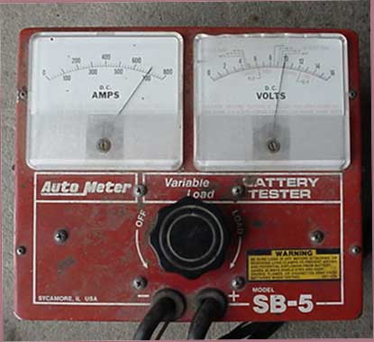

you should take the battery to someone ELSE and have it LOAD TESTED. A Load tester looks something like this:
(Carbon pile load tester)
NOTE. This is showing a load of 700 amps at 10 volts. That is one HELL of a battery!!!
If your battery really shows OK with a reliable load tester (and someone who knows how to use it)
Then you need to buy a multimeter, if you don't, and should have, anyhow.
Just like 440 says, a battery needs to be LOAD tested. It can show 12v and still not have the capacity required to turn the starter.
