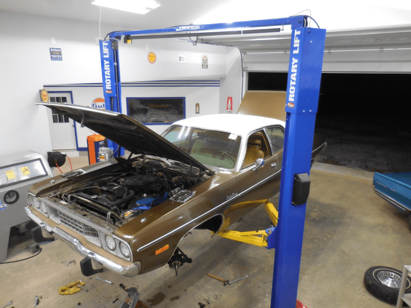

On an asymetrical the rear arms are longer than front. Moves the vehicle back a bit and makes it essier to open the door for access since the lift post doesnt interfere so much. You can deal with heavier vehicles, just need to pay attention to vehicle center of gravity so youre not too heavy out the rear. Of course you need to watch center of gravity all the time youre using a lift.

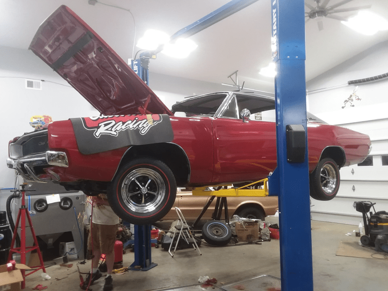

I have one of each and the asymmetrical still weirds me out! I always feel like the vehicle will fall back at any moment! Of course I've had zero issues but when I buy my 3rd 2 post it will a symmetrical!
I have an asymmetrical lift with a clear floor. I wouldn’t want the floor pan style, but they need a little less ceiling height. Probably a 9000 lb. lift is plenty. My four door Cummins 2500 4-wheel drive with 8ft. box weighs 7400lbs. with me in it. Just my opinion, of course.

Correct to both. You can get the door open further with an asymmetrical, but still not wide open. It's then easier to get in and out. As a very rough guide, on a front wheel drive car you line the dash board up with the uprights and on a rear wheel drive car about the front edge of the seat lines up with the uprights. A pickup would be different and again different between 4wd and 2 wd. Then there's the box length to keep in mind and I'd recommend the box being at least close to empty.
You're just trying to make sure you don't have too much weight out front or out back. It's not that difficult to get a feel for. I've had a Challenger 9K asymmetric for years and haven't killed myself yet. Have had cars (even rear engine ones like VW's and Fiero's), pickups ( 2wd, 4wd and crew cab), a car trailer and a late 70's vintage Dodge dually dump on mine.
