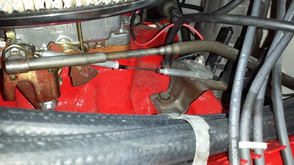

What carburetor and what manifold? The stock single rod kickdown works with the factory cast iron 4bbl manifold and Edelbrock carb ( with Eddy throttle adaptor). The rod gets moved over the next finger on the cable bracket.
I set mine with throttle completely closed and adjust rod to drop onto the pivot. Check at wot...trans lever should be about all the way back.

Unfortunately the only way you can tell if the swing matches is to use a set of verniers on the tranny lever to see how far it travels from "rest" to fully back. You will also need to do this at the carb attachment point and compare the two values. ! 1/4 to 1 5/16 sounds about right but you can change the progression by moving the attachment point at the carb closer or further away from center of the throttle shaft. Both should be equal which will allow WOT.If your not holding second or can't get partial pedal "kickdown" you have too much slack in the linkage or to put it another way, the tranny lever isn't pushing back far enough. Try the extreme adjustments both ways and you'll see what I mean.
That's how I remember adjusting mine when I installed the 4bbl. It now has an Eddy carb on it with the rebuild. My old AFB off of a 64 426 has disappeared. Still the stock manifold I had on it. Car is at top shop getting a new one on it; I'll have to check the lever adj as I didn't do this after work was done. I notice your throttle cable is a nice straight shot; mine is bit angled upwards to carb linkage. Unrelated but seems not right. Thanks much Threewood and Miller!

Just keep in mind, at WOT, kick-down linkage back, allow about 1/16" play, before it bottoms out. That's for no binding. The linkage is spring-loaded (inside the trans), and the first 1/3 travel is free play.
When you change from a 2 barrel to a 4 barrel setup, the linkage changes. The transmission linkage often needed up to a inch longer rod(at the carb), if using a standard Performer intake. If using a RPM intake the linkage may need to be longer, welding in some rod was the normal fix. After paying attention to the factory settings and trying to copy them the best you can. I liked putting the adjustment in the middle of its range, giving some wiggle room that way. The throttle cable normally will still work after checking for full throttle opening. If the motor is running right how could you tell if the throttle was only opening 90 percent. On the street you couldn't.
