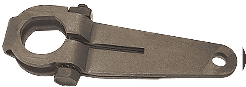

Are you talking about this style? I believe the Star Shifter I put in the TA had one of these in the kit. That would be awesome if it fits. And now if I can find it lol.

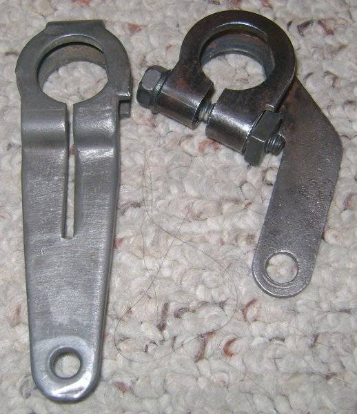

View attachment 1850784 View attachment 1850788
If that works, let us know. I have one of those crooked levers in a box of hardware, on the shelf. I thought it was for a different trans or shifter set up.
