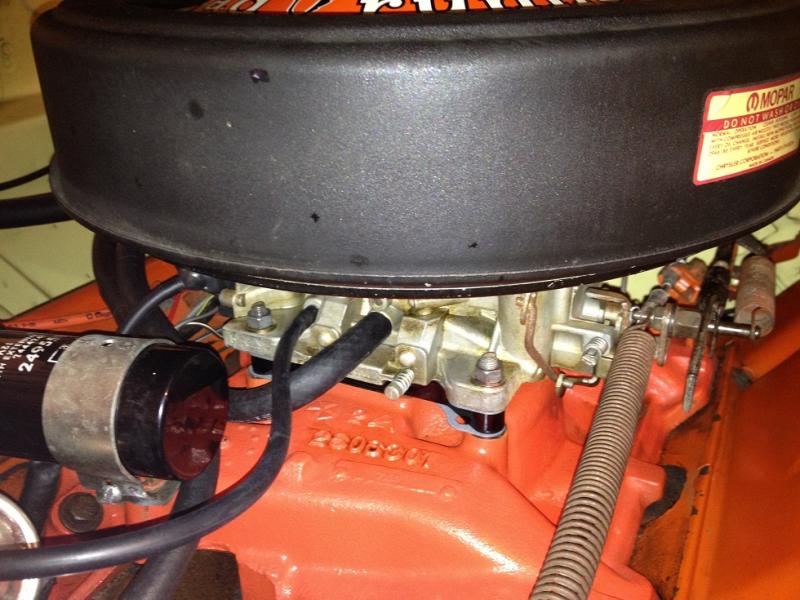

Personally, I would get an open spacer. This is what I have.
