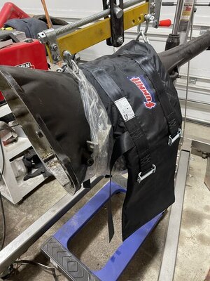

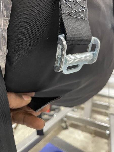

It did not fit! I called Summit to see if they had one 2-3” longer. The longest they have is just a 1/2” longer than this one I have. Ughhh. The straps come around and are about a 1/2” away from the buckle. Another 3” longer strap would work. Can I use an unattached strap? Or will it slip off after a couple passes?
B5463CEA-CA46-4C6E-80EF-06280B9242A0.jpeg F74EA7D8-87D0-487E-AE2C-CEBA8470E7C3.jpeg
I just checked Jegs and Mancini Racing, they all have the same ones. Has anyone tried to use and independent strap? It seems like it would work. I am out of options.
Ya, they all seem to be made for glides. I had to relocate my front strap location to the 727 ears. My under the pan straps barely fit

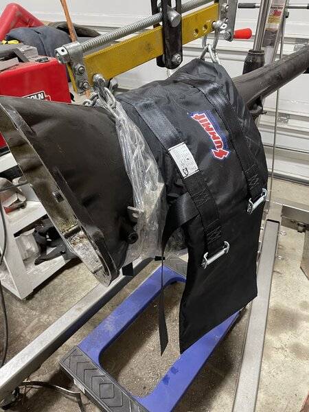

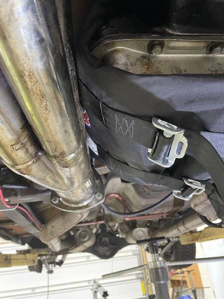

I did exactly what 66satellite47 suggested. I cut the side straps off the blanket, went to Joann fabric and bought some nylon thread and stronger needles, and my wife sewed them back onto the straps that were too short. I have the blanket in place, but I cannot get the straps to lock into the buckle. The other problem I can for see is the blanket is right up against my headers. I am sure those headers are going to melt that blanket. Does anyone have a solution for these two issues? Pics work best!
96FAE3B6-6537-4A27-B416-F99BBF4F4CE7.jpeg FED2BB72-92A6-477D-8C48-754F4729667A.jpeg
Try some asbestos wrap on the header near the strap. Why doesn't the buckle lock.
Again it's too bad the manufacturers don't realize that not everyone runs a Glide.
My friend stopped by and pulled the strap with some serious force (he’s much stronger than I am), and tightened that strap so it does not move. I just told him my arms were weary from all the work I was doing on the car. He said, sure! Anyways, my blanket is installed. I will take a picture when I go back out to the garage.
