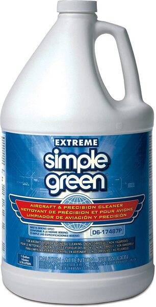

In the video he said not to use Simple Green aluminum carbs. Thanks for the help. Dave
There is a version of Simple Green that is safe for aluminum. It's approved by Boeing.

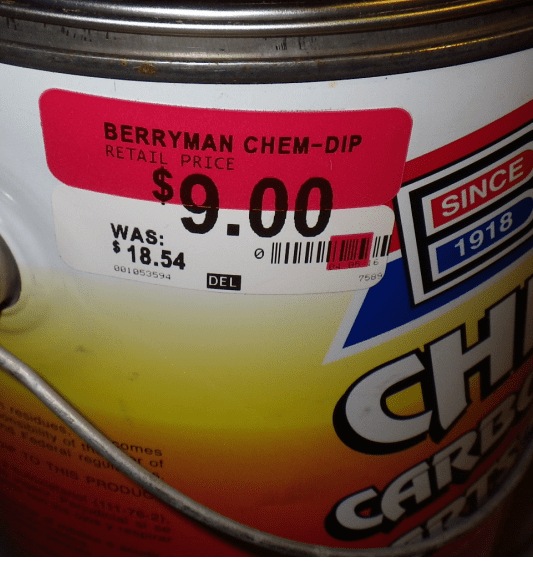

A while back I caught 2 gallons of Berryman's in a store closing sale. Seems to work pretty well, but I still needed to brush parts to "help" the process.
I had a really cruddy Holley primary fuel bowl that wasn't cooperating. I stuck it back in the can but forgot about it overnight. Lol, turned it dark gray and chalky. Threw it in the scrap metal box.
