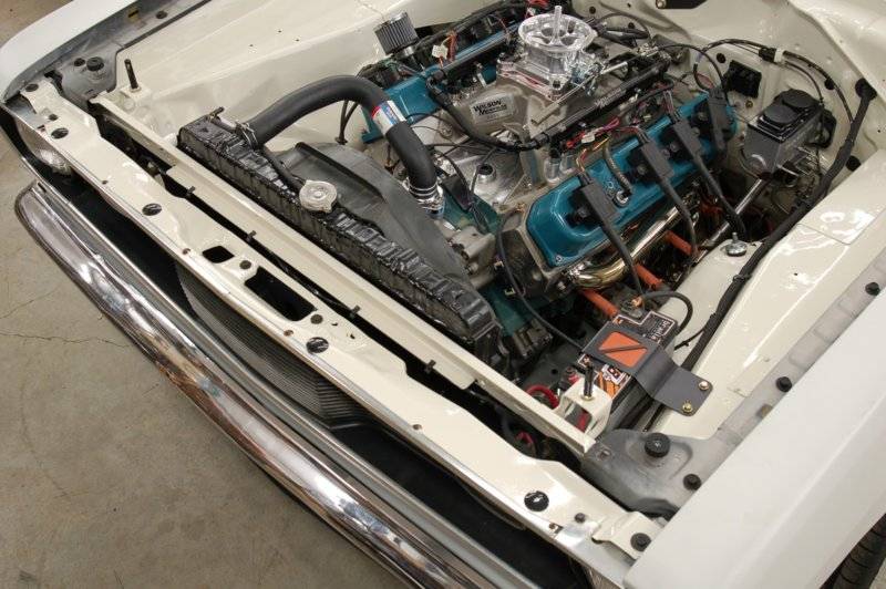

I have a Sniper setup on my Coronet but the Duster got the full meal deal. Sequential port injection, no distributor, 8 coils, etc.
Dominator ECU with the Pro Dash, GPS, etc. All the bells and whistles on this car.

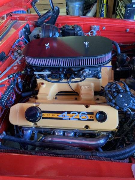

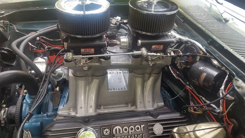

Okay, Dennis. Mine is a Walbro 255LPH pump. I have about 3,500 miles on my dual Fitech system, primarily on the factory crossram and now on an Indy Modman intake.

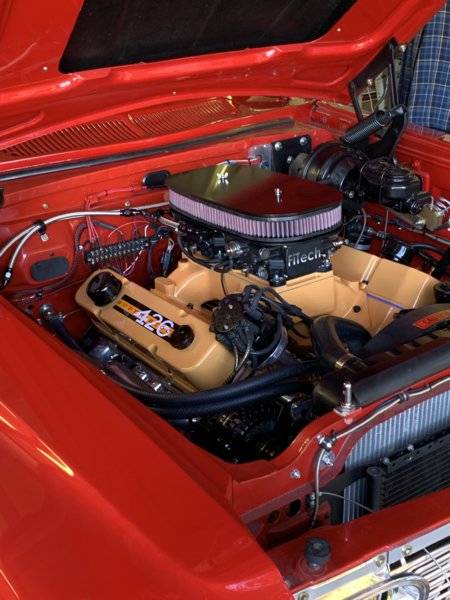

FiTech, Tanksinc, Hyperfuel, ptfe lines with Fragola fittings, Toyota alternator, new wiring.
Bought an MSD for the efi to control, but not yet installed.
Yes, definitely more $ needed on top of the efi unit, so don't skimp, but it's worth it if you're prepared.
It will not solve existing, unrelated issues.
Drove it for years with Holley 390s, then 600s, different animal, then efi, nice!
