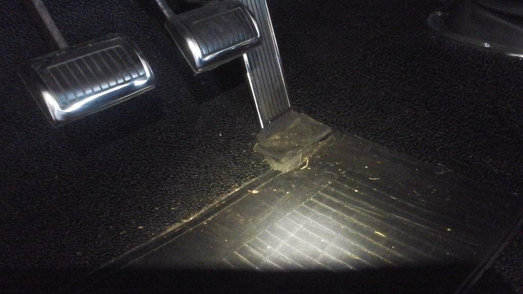

On my 69 RR I did, that bulge in the throttle pedal requires it. Here is a pic if that helps.

I have examples of original carpet showing the proper cutout for the gas pedal. The foam does go under the carpet and the carpet gets a rectangular cutout opening. Just look at the bottom side of the pedal for a template...The throttle cable bracket has had two plant variations on how the carpet was cut of that as well....
