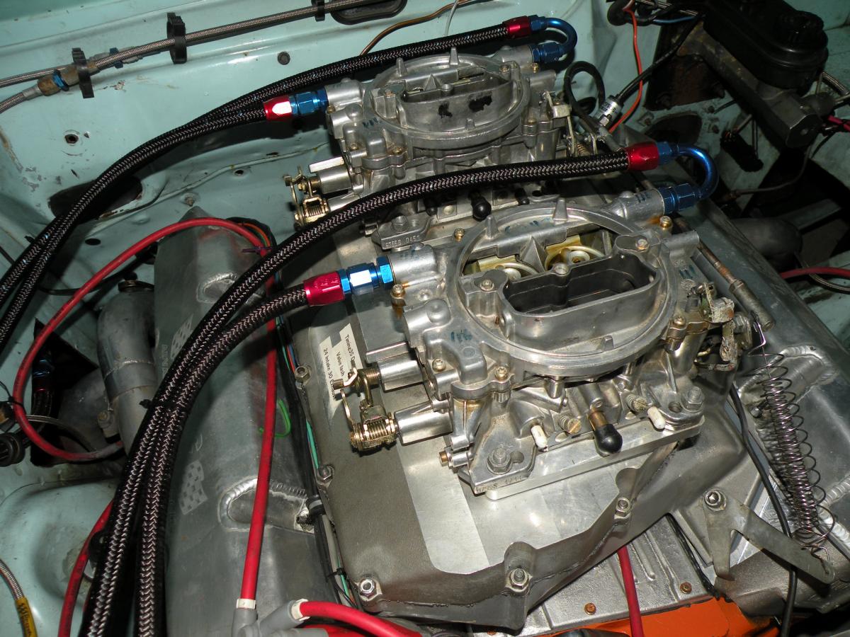

YES.floats too high causing it to blow thru the needle and seats and coming out of your shafts.
