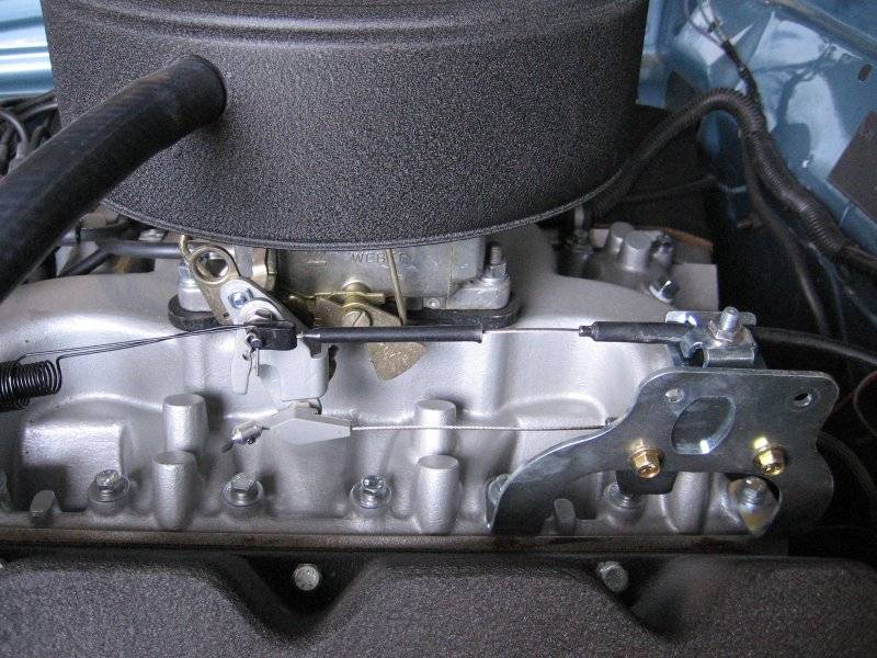

Yes it should.You will have to use the Mopar linkage adapter. I painted mine silver,they come in a gold color.Also use the thick Eldelbrock base gasket.

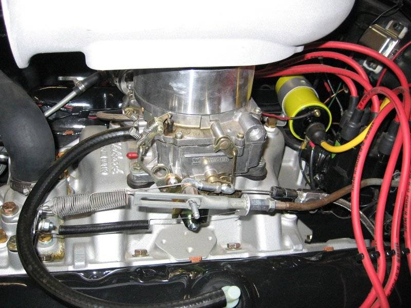

The 650 AVS2 is a good street carb. Photos show 2 types of kick down if you are using a Auto Transmission.

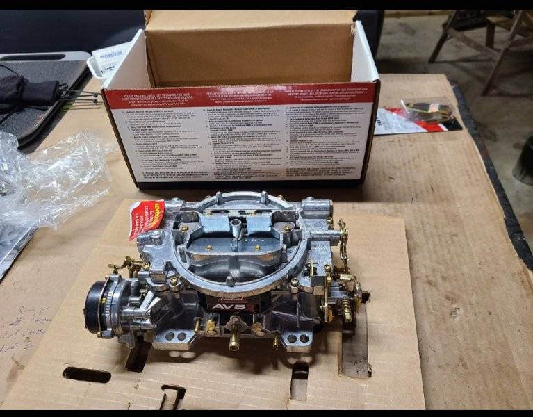

I ordered one yesterday from Summit with the adaptor.
Coming today. 800 CFM.
Talked to Tech at Edlebrock first and he said I would needed that with a manual trans.
I read that was the case from a review and wanted to confirm it.

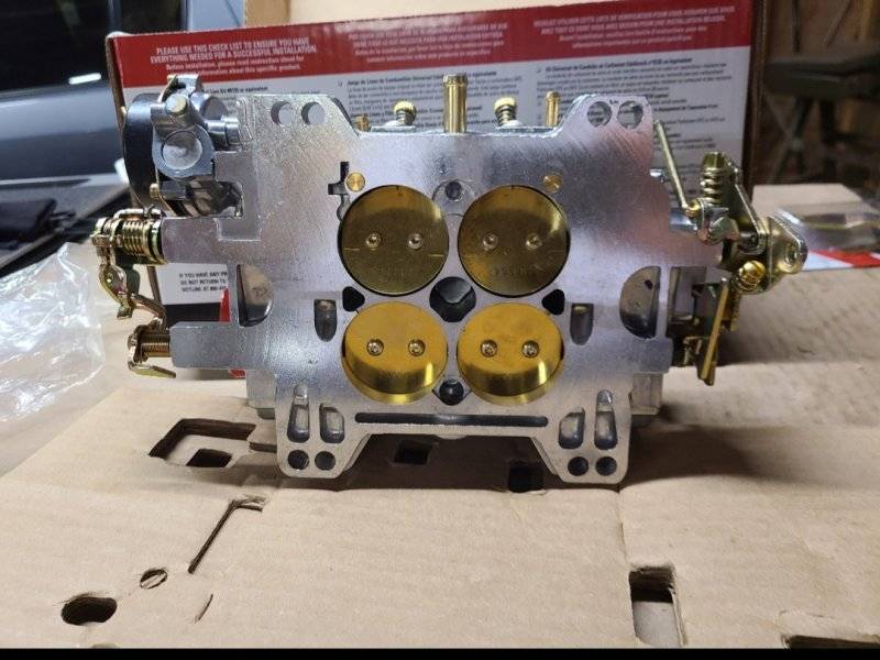

The pictures show what I would call spread bore. Listed as a square flange.

Do you have a stock 1967 383 intake? They have the narrow bolt pattern so the AVS will need to have two holes on each ear to fit. Also pretty small throttle bores so measure your intake bores first to see if a 625 will fit.
If you have a 2806301 or 2951666 intake it will fit with wide pattern.

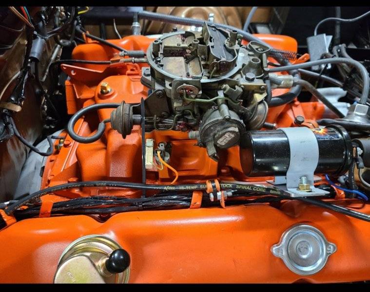

What are your plans for that Rochester that you are taking off. ?
Years ago I would go to Pull A Part and get them.
Had to get there as soon as he GMs hit the ground or teo guys and a wheelbarrow would get them first.
Long story to say I've run them on my car's exclusively for over 20 years and have two or three.still in reserve.
And LOTs of jets and needles etc.
But this is not a junk yard motor and I wanted a nice new design carb now that I've run it for the first time
I knew that it was a good carb. Just took it off another car after a rebuilding it
