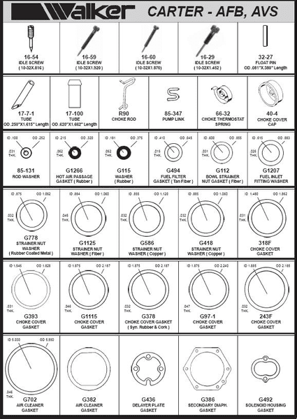

Where might I find the 10-32 mix screws with the larger diameter needles or what carb would they have been fr so I can look them up?
THANKS
Walker offers many parts for Carter carbs, specifically 3 different idle mixture screws all with the 10-32 thread size but different lengths. Perhaps one may offer a partial fix or could be modified to help. Just a thought....
BOB RENTON
Walker web site: www.carburation.walkerproducts.com
THANKS
Search Ebay, can look in the walker catalog at other carbs. Won't be an AFB, but holley, rochester, etc...
