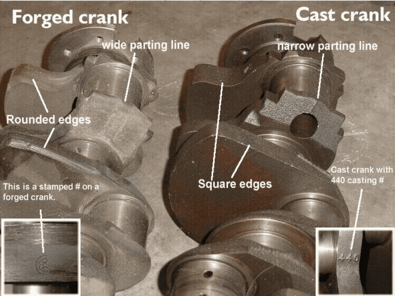

The cast crank has a damper that is external balanced with
offset weight. The forged crank has a smooth balance without
an offset weight on it. Best way to tell in a complete assemble engine.

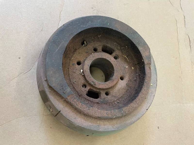

Harmonic balancers are different for cast and steel. One of them has a counterweight built into it.
Cast crank balancer.
Steel crank balancer.
Like shown above that thick ugly harmonic balancer will tell you...

It’s got the steel crank balancer on it, but he don’t know what crank he put in it.
They should match, usually you'll know it if they don't. Many cast cranks were not drilled, but the only way to really be sure is pull the pan.

No hole in the back is a cast crank. Take it apart. Get a steel crank and check the depth of the hole in the back of the crank and have everything balanced. U can use a pilot bearing from a 90s up truck. Kim
