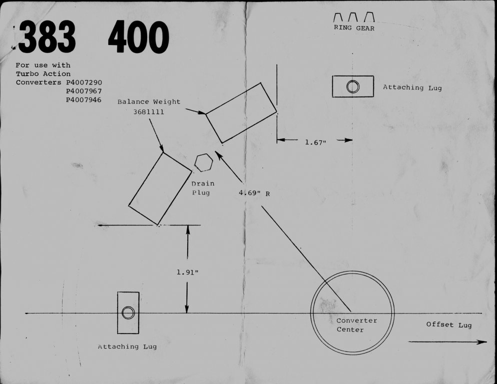

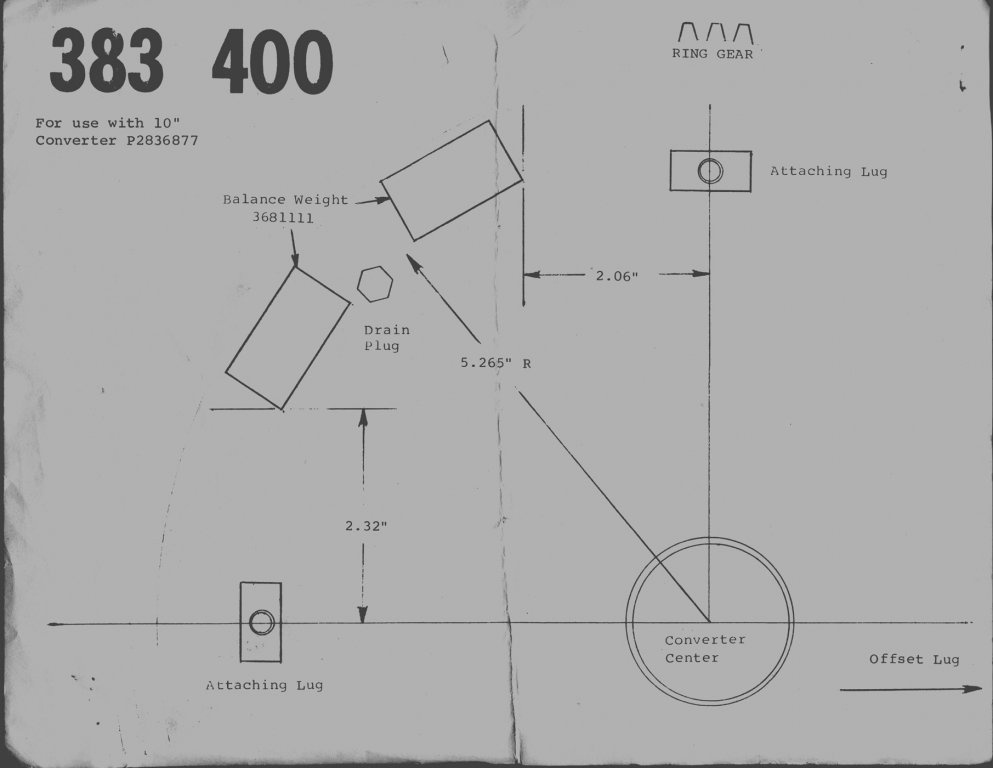

about bolt on options, we have the "counterweighted" flexplates, and added on counterweights.
Flexplate kind:
and added on counterweights:
( no image at this moment but KMJ performance on ebay used to sell those. Will edit and post when I find. They bolt to the crank )
