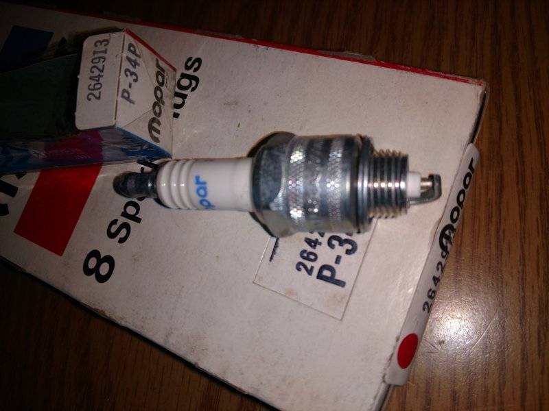

Is the J11Y supposed to be the factory plug on big blocks (specifically, 440's)?
I went looking for some after I just installed a set of the only plugs the parts store had in stock recently (NGK). Needless to say, not impressed with those.
I then snagged up on an original set of Mopar 26422913 P-34P spark plugs still in the box for a pretty good price I think.
Were these the original plugs in our big blocks? Are they rare to find these days?
I paid $20 for the set of 8. How'd I do?
the advantage to the j11y in an iron head is the length of the projected tip and heat range. the j11y and j13y were designed specifically for the big block iron head. the perfect spark plug.
IMO, $20 for the J-11Y set is a good deal and they were the popular after market plug for BB Mopar as opposed to the Chrysler plug.
people bought the j11y because it was cheaper than going to mopar and buying the p34. they are the same plug.

What was unimpressive about the NGK's?
Well thanks y'all. Yeah, I'm kind of tickled to get these at that price. They didn't show up at first on eBay using normal search but I learned a long time ago that eBay's search engine has some odd characteristics to it and that items get "lost" on normal searches.
I did a little backdoor digging through a portal and there they were, languishing with no bids and a day left.
Watched it, snagged it. :)
Now I'm rethinking actually installing them.
Any collector/artifact value to these? Kinda cool with the Mopar script and box and all.
These are just the garden variety "v power" ones, but they're certainly a colder plug than I need. You can just feel it in the idle quality and tip-in on the throttle; just a little sluggish to respond, especially until the engine is fully warmed up.
My butt-meter tells me they need to be a warmer range.
That can happen with any brand of plug. I found even the original factor Champion plug undesirable in a built BB. Reliability was the key reason for ditching Champions in the 1980s. Simply got tired of plug failure after a few thousand miles.
I always ran Autolites in my 440 cars back in the 80's. You're correct, the Champions of those days had gone downhill in quality.
My current engine certainly isn't "built", just a rebuild of a stock one with a bit of porting and a 484 purpleshaft cam, headers, etc.
Problem is, where I live the parts stores don't really carry a lot for older rides; everything is ordered, which of course I can do instead.
Regardless, here I have some original Mopar issue Champions (notice these were made before the part number was superseded), so I'd guess they
are the "good" old OE Champions.

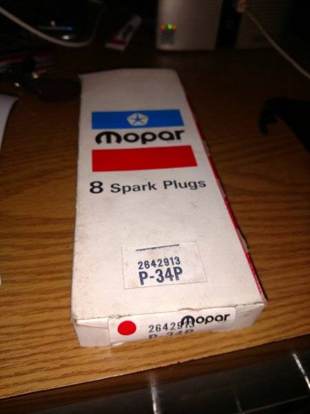

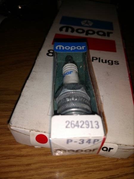

View attachment 607663 View attachment 607664
what's interesting is to compare the projected tip length on the j11y to a j10y, j12y, autolite 85, 74, 75 or any other 14mm 3/8" reach plug. you'll notice the j11y tip is longer and non-resistor. big block mopars have a very crummy combustion chamber. the plug is at the extreme end of the combustion chamber and then combined with a large bore. all the modern 14mm 3/8" reach plugs are designed for the small chevy chamber. the difference isn't great but every little bit helps. somewhere in the '70's a OJ11Y was made; a resistor version of the old j11y. all modern plugs have about 5000 ohms of resistance. this may or may not be a problem, depending on other factors, but should factored in. I don't get lost in who's name is on the plug anymore. I do physically compare heat ranges and tip lengths and keep an eye how they burn.
