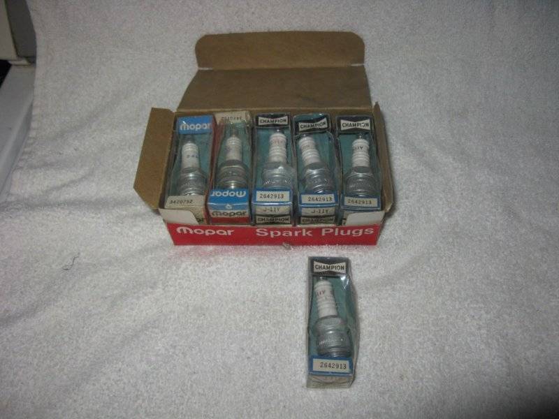

I then snagged up on an original set of Mopar 26422913 P-34P spark plugs still in the box for a pretty good price I think.
Were these the original plugs in our big blocks? Are they rare to find these days?
I paid $20 for the set of 8. How'd I do?

Question 1: Are the J11Y's OE for the big blocks? Answer: Some, yes, including mine. My own FSM also agrees.
Question 2: Are these plugs rare? I'll answer that one as well. J11Y's are out there for sale somewhat. From what I've seen in digging around, they go for about double what I paid - but here's the kicker:
Mine are the equivalent Mopar-marked originals still in original packaging.
I bought these to use, but I'm having second thoughts now because I haven't found any more of them online so far. At all.
Question 3: Did I get a good deal on these? Most assuredly, again based on what's out there for sale right now.
Question 4 (added later in the conversation): Do I hoard these or install them?
Jury is still out on that one, since nobody has offered any opinion on that one at all. :rofl:

Wait a sec. According to my FSM, the P-34P's or Champion J-11Y are the "specified" plugs.
Are you telling me the Champion was the factory-installed one and the Mopar ones are the "aftermarket" ones here?
The ones you have are the OTC mopar part....
The chanpions were the factory line part....
Line parts are not always the same exactness as the OTC part......that why you have to know or know someone who can differentiate them.....you have to be careful when you buyNOS parts of any type....there are subtle variations.....
I have been involved in the OE world for over 25 years....their are very very few cars that can meet a 90 plus correct scale.....it is more than just plugs.....
So those Mopar stamped plugsare incorrect if your trying to be an OE coreeco car.....
If we don't preserve what is correct than people can think they can put on whatever by a part number cross reference.....
Got ya, thanks.
Learning all sorts of minutiae about these plugs. These are the "first gen" plugs, anyways, as Mopar superseded the part number later on to
3420752.
It's also interesting that the part number I have superseded a bunch of numbers that came before it in Mopar world:
1889521, 2095247, 2098334 & 2098337
Not only that, but Mopar sold plugs marked Champion J-11Y in combined Mopar & Champion packaging showing the original Mopar part number:

There were a lot of variations.......The correct j11y for 69 is a champion only plug....and the champion j11y stamp is an brownish color.....Also look at the plating on the bases between the two.....The colors of the stampings.....
So as you can see through your research. When you start breaking things down to the fine details......Finding the correct parts is very very difficult.....
Try to find an original assembly line oil filter that is correct for that model year.......When you do you may want to bend over first.....
Better than that, try to find a correct trunk seal with the pn moulded on it......
The list goes on.......
I enjoy the preservation of history in the relation to these machines.........
That's neat and all....but mine is a '68. :-)
