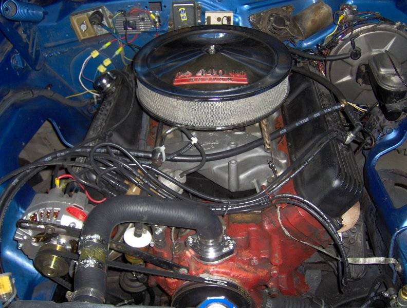

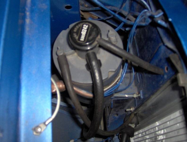

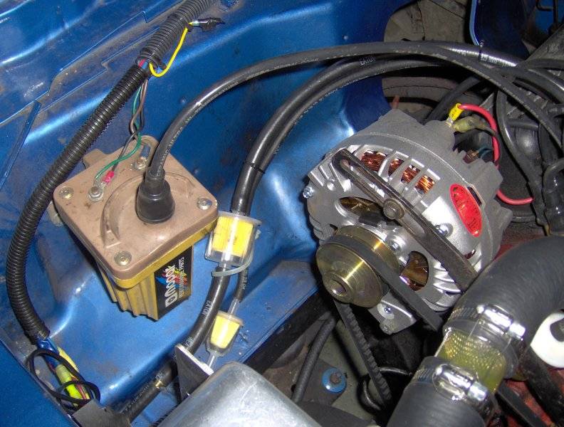

I was in a similar situation years ago. In fact, mine was dangerous. The car was set up for bracket racing & stripped of all creature comforts. When I was installing traction bars to compliment the coil overs & leafs in the rear, i noticed with horror, that they had cut the fuel vent line & left it open venting about 6" from the hot 3" exhaust pipe. I think I temporarily hooked a hose to it and vented it elsewhere away from any heat. I looked at several canisters and ordered one from a vender. Well, it didn't fit. I was helping my son with his 93 Jeep wrangler & noticed his canister and it looked good to me. Close in size & had 3 ports. I went to a bone yard and the guy I spoke to said he had one for $20. I thought I had to pull it but found he already had done it. So, I installed it on my 73. (by the way, my 440 is from a 1968.) I mounted it in front of my rad support as they had mounted my coil where the canister was supposed to go. I drilled some holes and ran it through. One thing to note when using an older canister, is, I read that sometimes the charcoal can get sucked into your vacuum system. So, I put a couple of reccommended filters between the canister and the engine. Here are a few pic's on my solution and it has been trouble free ever since!

Looks like you have a fourth hose outlet that is left open. Is this the air vent to the canister?
Unlike the Mopar canister which I believe were vented from the bottom through the fliter? it appears most of the aftermarket ones I've looked at have a similar hose outlet marked as "Air" on the top. I assume this is the vent for these cans and there no hose goes on it?
Unfortunately, I am at work at the moment and can't check it. If memory serves me correctly, I think that port on the top is cast closed by the manufacturer. I looked at my sons Jeep before I bought the canister from the bone yard and his is the same way with that extra port blocked off. I can only assume that there was another application for that canister that used that port; another make or model. Remember that Jeep was a Chrysler product since 1987.

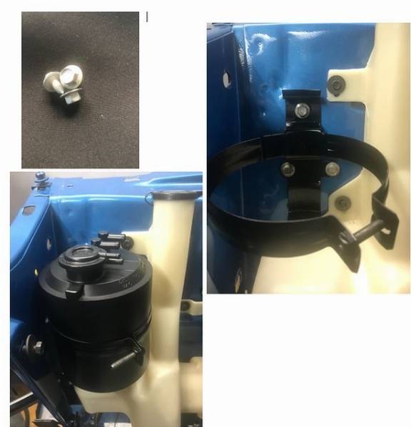

My '72 didn't have one all the years I've owned it and never needed it, during the resto I wanted to fill in that space so I am adding one back.
Thought of getting an aftermarket but the originals were still around and I got mine for $60 on eBay.
Cleaned it up go a new filter and screws and installed.

I took a quick look today before going to work. The other port on top of the unit is a vent. I have headers and I connected the ports to the closest thing I could that my son's jeep used. One goes down & under the car to the fuel tank vent line and the other two are teed into the PCV line to the 4-barrel carb & the vacuum advance to the distributer.
