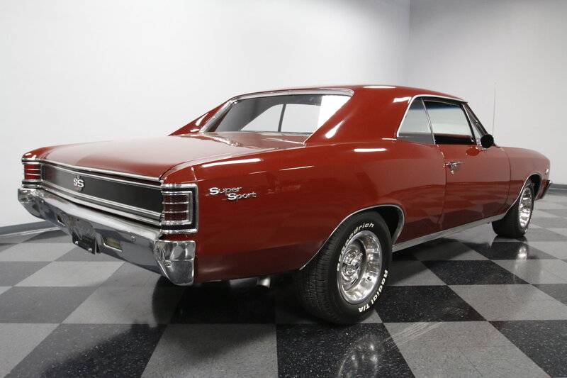

GM didn't mind losing the same C pillar when they made convertibles...
66/67 gm buttresses are not as defined but I've often said they are similar to 68-70 Chargers.
