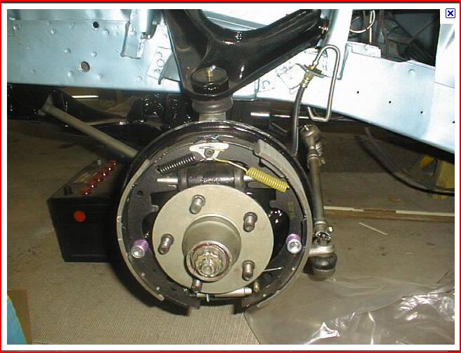

Is there a way to know if my right front brake line should go over or under my frame. 1968 Charger 383 auto with manual drums.
I remember when changing my lines, the originals were under the frame but the replacements were made to go over the frame on my 68 Charger.
They are awkward to work with so check before you start feeding the line through to the wrong spot.
Ask me how I know. Good luck. Great upgrade for safeties sake.
I was criticised for running my front lines below the chassis rail, as it was deemed correct according to all the pictures I could find. Several people told me at the time that above the rails was correct as the lines would not be damaged.
Here is one picture I used as reference from a restored car (not mine);
I honestly cannot see how running the lines above is any better than underneath as the factory designed. The lines are well above the flat areas where a jack or hoist foot would crush the lines.
Thanks for all the imput. I did research this a while back and there were cars made both ways . Maybe the difference was hemi cars or something. I have a lot of work in this car and I would prefer not to have to move the brackets. From the picture I am guessing mine shipped under. I wouldn't mind over as long as the brackets line up, but I'm not sure they would.
