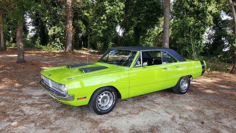

Well this is a 70 Dart also! LOL. Where did you get the new connector? What motor do you have in it? Mine's a 440 with a Paxton blower.

The bolts should ground the regulator, they must be tight! I think I ordered the regulator connector through Napa... mine is a #'s match 340/4spd car ..
