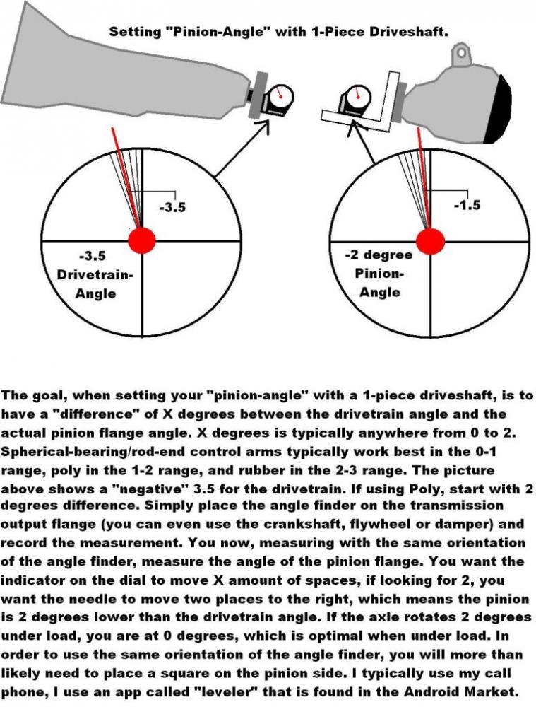

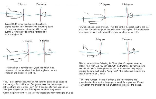

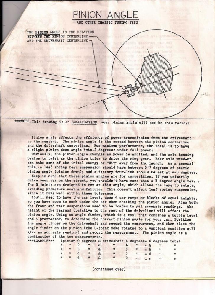

The only thing else I can think of is pinion angle.I set it at 0 when I welded the four link brackets on but not zero to the transmission angle.It looks like I should be setting with the transmission angle.Not sure what angle to have it at.
Thanks for any advise.Joe

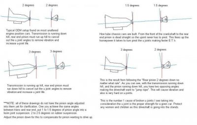

the pinion & trans should be close to a parallel/same angles
& the drive shaft slightly different for proper universal wear

You won't feel a pinion angle problem at speed, you'll notice it as a launch shudder. Look for something out of true or out of balance.
Going threw the same thing only mine is totally different (vibrates when the shaft is in a coast mode). I'll tell you what I've learned, like Bud said shoot for a parallel pinion and tranny angle with some angle left in the shaft angle. Here's a link to a cool app from Tremec for smartphones that turns your phone into a cool tool, it will measure all three angles and show incorrect angles as red and correct as green (seems pretty accurate when checked against an angle finder) http://www.tremec.com/not_am_detalle.php?m=355. Check universals as stated, make sure to check your slip yoke slop, loose mounts or bolts and make sure your tranny isn't touching the body anywhere. Also depending on your universal joints some caps have different thickness C clips using the incorrect clip will allow the joint to move back and forth in the cups. I think I've tracked mine down to my leaf springs but won't know until the weekend which doesn't apply to you. It's a process of elimination that can drive you mad so just correct everything as you go.

I followed the diagrams from your post Budnicks and set the angle up at 1 degree difference. The trans is 4 degree down and I put the axle pinion three degrees up for 1 degree of twist with the four link.With correct angle and correct U-Joint I am ready for some more testing.I hope the weather clears up this week so I can get some road time in.
4 deegrees seams like allot of angle, I tried to match the factory setup on mine and have the tranny at 2.5 degrees down and pinion up 1 degree which is untouched. I guess the important thing is the difference between the 2. Good luck, hope it works out for you.
