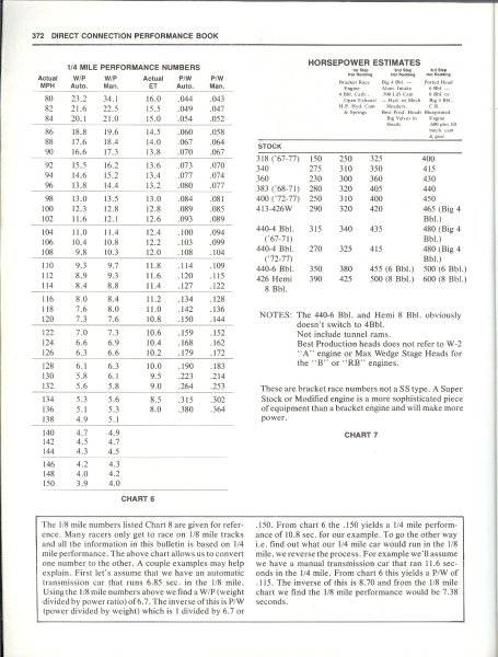

an interesting read is the september '70 popular hot rodding issue with a '70 6pak chassis dyno/drag strip test. i don't know how many times I've read that article. good info for somebody doing stock or near stock stuff.
Got a link or post pics of article?
no link. tried to take some photos from the article. i might have to get a 10yr old how to do it,..lol!
