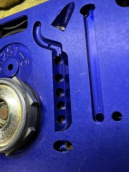

WOW! What a difference a few thousandths makes. Didn't change anything else, but dropped the IFR from .035 to .032
I did have to turn the idle screws out to a full one and a half turns and it idles at 13.5 now.
Cruising along around 1300 RPM is 14.5ish and my AFR's didn't change at speed and WOT. Amazing. Throttle response is incredibly snappy now too.
I am keeping an eye on the IFR jets I made (last pic), they look to be flush with the metering block gasket, I'm concerned it may not flow freely across that spot. But right now it's running better than it ever has. I can't thank you guys enough :thankyou:

JerseyJoe, I went through a similar exercise using a Promax metering block on my six pack setup. Reduced the screw-in IFR's down to 0.028" and it made a big difference in cruise AFR.
Just a suggestion, however, on seating those IFR jets - I noticed mine (like yours) sat nearly flush with the surface of the metering block. I tapped the threads a little deeper to recess the face of the jet relative to the face of the metering block. Might not matter, I dunno, but I was concerned about the gasket swelling a bit over time and obstructing flow into the jet.
Might be good preventive medicine.
