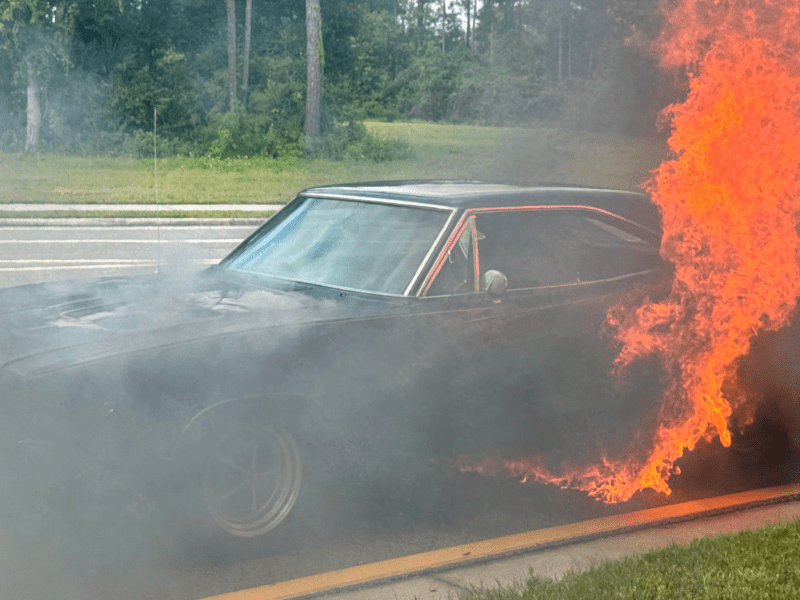

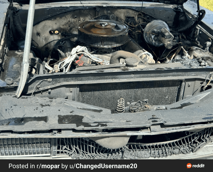

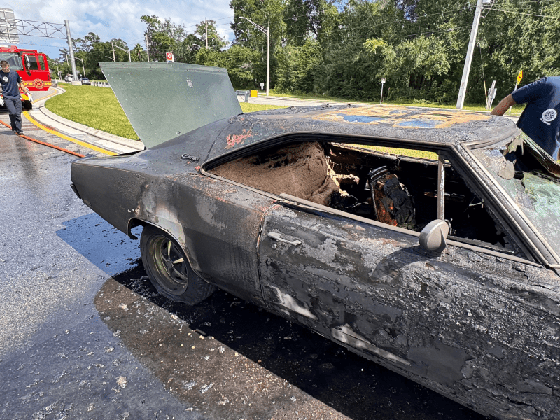

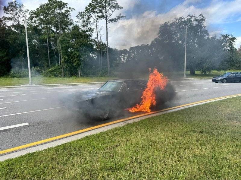

1968 Dark Green Poly 383/727 fuel line burst and with it 6yrs of work.

That sucks for sure but there has to be more to the story. Electric pump and higher pressure? Stock steel lines may rust and drip but don't burst because there is almost no pressure in them. Just a little suction from the engine driven pump.
Toolmanmike is right.. There is more to the reason for this happening. Seriously doubt it was a stock fuel delivery system is capable of causing a fuel line to burst.
Only time I've seen a fuel line 'burst' is when someone used regular fuel line in an efi application. And it wil let go with a vengance.

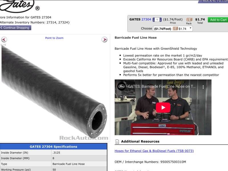

When buying rubber fuel hose get the barricade hose from gates. It will stand up to modern ethanol fuels. The regular hose will crack all around the hose like a tire out in the sun.
Rock auto has it for $1.74 a foot, and the regular is $1.28 a foot. Working pressure is 50 psi. Well worth 46 cents a foot more.
Don't forget the rubber hose at the fuel tank and on a C body the rubber hose at the rear of the subframe.
More Information for GATES 27304
