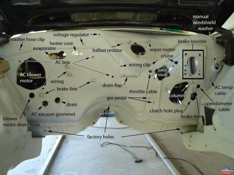

I am trying to figure out how the choke cable is fed through the firewall? originally it seems the guy drilled a hole and put the cablecable through. is there a specific spot the cable should be fed through? im guessing a grommet should be used?
i found the attached picture but dont see anything.
thanks
Any modern vehicle like a 71 (which is quite old) would not have a manual choke cable.
They were all opened by a pull off and a bi-metallic spring.
But yes if you are going to run a cable a grommet is a good way.
