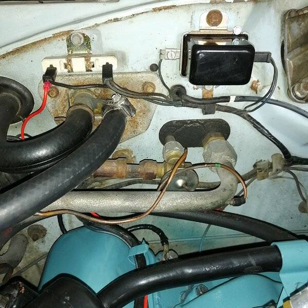

I just wired up my electric choke on a 66 Charger. It was very hard to tell the wire colour, but the brown wire was on the drivers side of the ballast resistor, so I plugged in to the other side. I also couldn't tell which wires were leading to the voltage regulator since they were all wrapped in the harness. Does this look correct?
I am electrically challenged. A test light is more my speed.
Run a wire 18 gauge from the field like Mopar did in 72 and up. You only want power when the car is running not in Run.
To be clear that would be the left lug on the voltage regulator, correct? That would be better as it would be screwed on.
Switched it over. The Fld side was clearly marked.

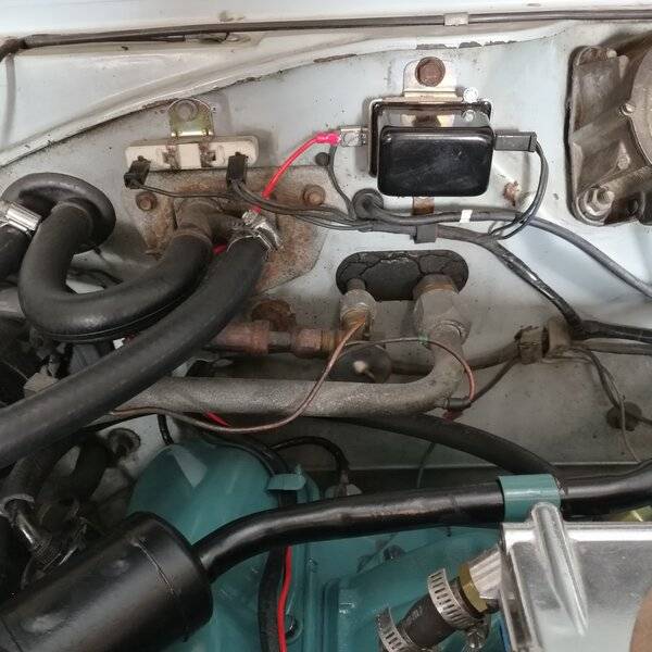

Ended up switching back to the ballast resistor. I drove to a car cruise with it hooked up to the Fld side of the voltage regulator, and the ammeter fluttered constantly. On the same drive back home hooked up to the ballast resistor the ammeter was rock steady. Why I have no idea.
The field side of the regulator is a pulsating positive signal ( internal relay closing and opening to regulate the field to the alt ) on single field/mech regulator.
It would need to be hooked up into the ign side. Which is the same source than the ballast blue wire side. So if you already made it into the ballast at the blue wire side, you are set.
( never into the brown wire side of the ballast )
On electric reg/dual field, factory hooked the electrical choke assistant power into the wire running to alt field but on the CONSTANT POSITIVE side, which comes straight from ing switch throught also a blue wire. On these, the regulation it happens on the other wire closing in/out the circuit to ground
On both systems the regulated source runs throught the green wire BUT, they work diff.
