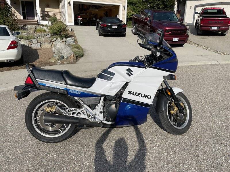

I just wrapped my entire Suzuki. First time I've did it. Buy the material and do it yourself, it's pretty basic.
