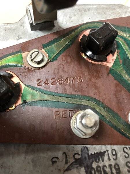

I am in need of board #2426475, I found a tear in mine with missing pieces. This is from a 1964 Plymouth Fury.
Your numbers don't match. (Ad vs picture)
Anyway, I repaired the circuit board on my old 69 Coronet. It had a burnt out spot. I was able to solder a jumper wire across the damaged area, and it was good to go.
This is where one of the bulbs mount, fixed the ad, thanks.
