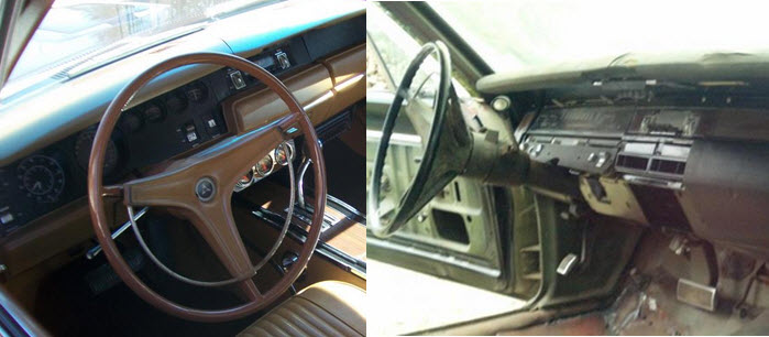

I have never owned my dream car, which is a 1969 Dodge Coronet. If all goes well, I could be in the market for one next summer. In the meantime, I spend a lot of time looking at (and drooling over) pictures online. I've noticed that there seems to be 2 different styles of gauges for this car - some photos show 2 large circular gauges and 4 smaller ones. (like the photo on the left) Other pictures show the wide, horizontal-style speedometer, (like the photo on the right) which presumably also contains the fuel gauge, temp gauge and ??
So was this a mid-year change, or is it some kind of upgraded gauge package? I've heard the term "Rallye" gauges, is one of these configurations a Rallye package, or maybe it's exclusive to R/Ts, SuperBees or something?

The circular gauges is the Rallye package which I'm pretty sure was standard for the Super Bees. The sweep gauges was probably common on the Coronets. Definitely need to figure out which gauges you like better.
Most Coronets got the sweep cluster, even the R/T. I've got a 69 Coronet R/T that has the upgraded Rallye dash with tach option so it has the round gauges you refer too.
Rallye dash was standard in the Super Bee with no optional dash.
Horizontal gauges with 120 MPH speedo were standard in all other Coronets.
The horizontal 150 MPH speedo was standard in the R/T with the Rallye gauge set up optional.

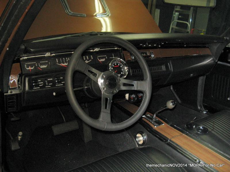

OP: Mine looks like this now if you want some more inspiration.

You'll need to swap out the entire dash, unfortunately.
Just what I thought, and there's no really good options to modernize the dash I got either. It's a bit shaky right now to say the least, bouncing needles, pretty bad illumination and so on. Since I need to pull it out and send it back to the US to refurbish I've been looking at rally-e dashes as replacement..
