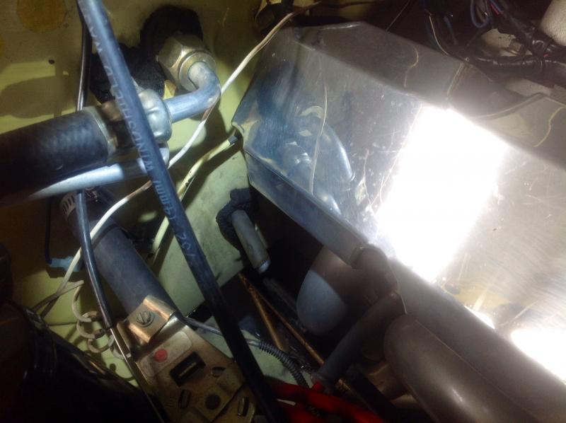

Won't help your question, but this is Classic installed on a non-ac Coronet from the engine compartment side.
