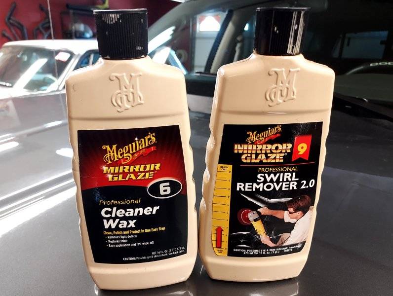

Mequiars makes a great product for what ever you need. I'd try the Swirl Remover or the Fine Cut if the first doesn't work. They have a Cleaner Wax but it might not be aggressive enough. Using a machine has the best results but a lot of their cleaning products can be used by hand.
Dont buy the red bottles at Walmart. Not the same. Paint suppliers or Napa carries the tan bottles.
