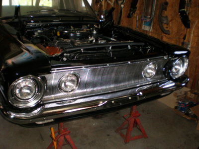

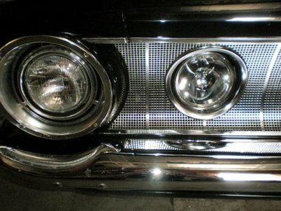

Spend the money and have it re anodized if you can afford it,you can polish it all you want but eventually it will start to get a milking looking finish. Clear coating polished aluminum will help buy eventually will wear off. All external aluminum trim that is exposed to the elements is anodized,only way for long term protection. This grille is original to the car,never touched,the bezels are 55 yr old N.O.S.
