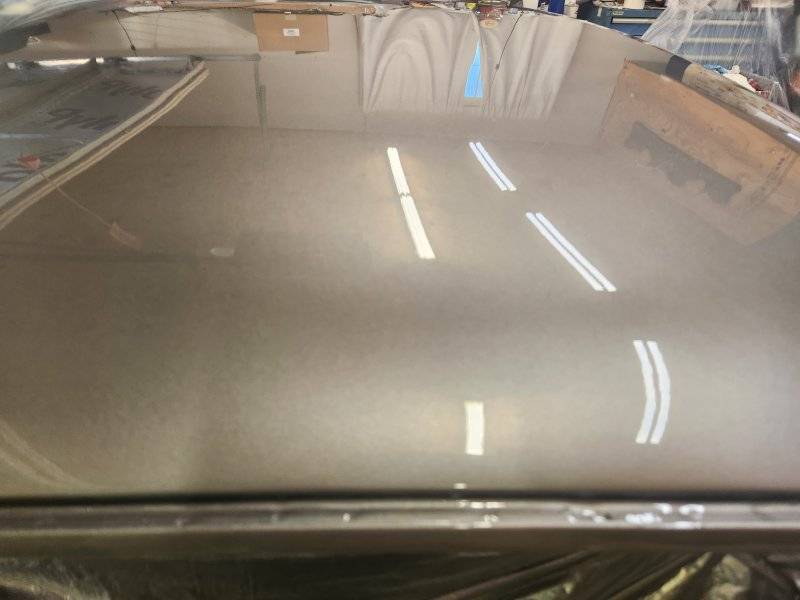

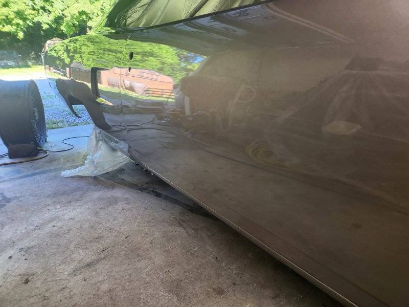

Not the best pic but, heres what im working with.
Only thing I will add is start wet sanding at the bottom and work up.
When your working off the floor and no lift the bottom 1/3 of the car is more work, standing on your head lol,
Get that area while you all happy and having fun.
Fresh like it is it will cut better, keep everything clean. Water, bucket , paper ect.
Looks good.
