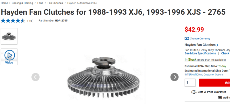

Correct ..... I'm using a Hayden shorty ....
HDA-2765 - Summit Racing Part.
Beware.....you will need the fingers of a Chinese waitress to install this......not hand like pork chops. :lol:

Correct ..... I'm using a Hayden Beware.....you will need the fingers of a Chinese waitress to install this......not hand like pork chops. :lol:

Yep, in post #10 there's a link where I use a 2765 jaguar clutch with a 22" radiator. The 2947 is slightly shorter, I haven't found a need for it yet though.
