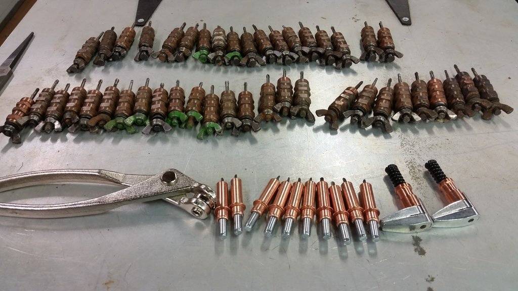

Which will be most used in the build? The $15 ebay acquisition or ~70 army surplus wing nut old school clecos OR the new school eastwood ~$40 kit with horribly few clecos?
???? I'm still using self drilling screws to hold panels tight lol.
look at summit they sell cleco in large bundles cheaper than eastwood also check amazon
LOLOLOL that's what I'm wondering! Did you answer the poll!? Your answer would have been #3!
Sure did....
Snakeyes is right, shop around (I've always found Eastwood to be more expensive than everyone else).
Those aren't "old school" clecos . . . the copper colored ones only have a fixed amount of force that you can place on the joint, the wing nut type are capable of providing a much larger amount of force to keep the panels tight while you're working on them. They can be really torqued down on the panels - it will make a difference in some cases . . .
I much prefer the wing nut types and wish that I had a bunch more in my toolbox . . .
best thing to do is shop around ,even shop craigslist and other auction sites but watch your used ones some can be abused
Personally I find clecos have limited use in a resto. If you're building airplanes with rivets they're ideal but if you're plug welding panels you don't want a lot of holes that you need to fill. Sheet metal screws strategically placed get the job done well and require no special tools.
