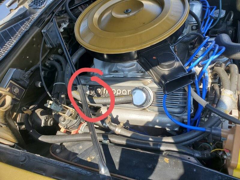

I utilized the steth and was able to locate it on the passenger side rocker cover, with loudest seeming to be towards the rear of it. Honestly, it was all pretty similar though. Drivers side rocker sounded smooth.

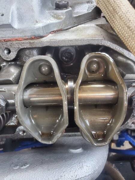

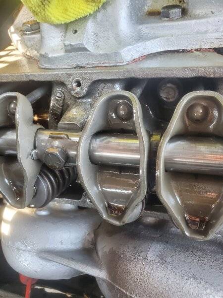

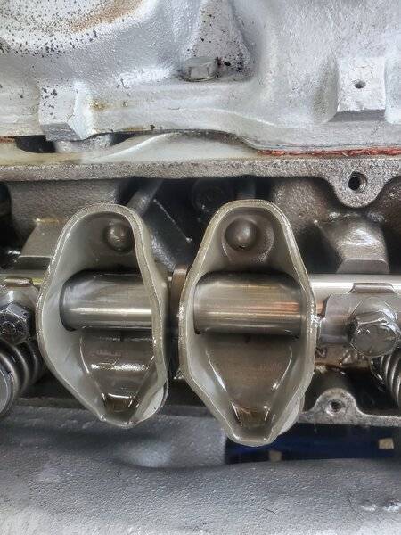

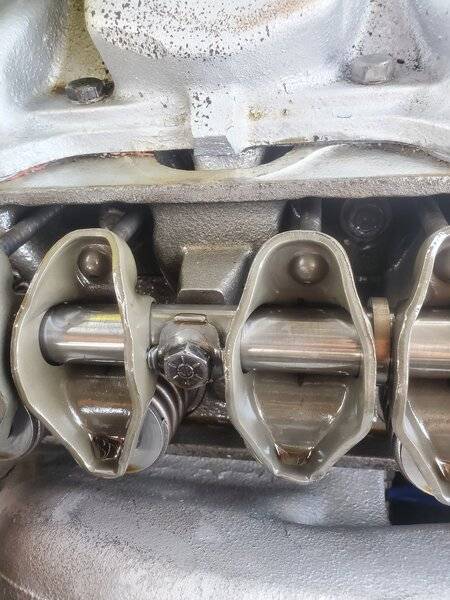

Well, pulled the cover off. Nothing looked out of place as far as I'm concerned (upload photos).
Cover wasn't being rubbed against or anything unusual like that. Rods don't look bent. My diagnosis may have been off. Sounds like it may be coming from more center of the engine beneath the intake?
Unfortunately, I'm garage-less for the time being and am going to have to call it a day. I will be continuing to search for possible solutions and troubleshooting.

Couldn't you start it without the valve covers and just take a good look to see if you see anything obvious?
Before you start it with a valve cover off push on each pushrod and see if the lifter collapses. They should never just collapse if you push on one.
I suggest cranking it with a wrench or starter with the coil off. Do all the valves move? Could have wiped the cam. Metal flakes in the oil…
Hey there! Thank you for the input. I did fire it up and looked but there was nothing obvious. There's a few more places I want to look, but won't be able to for the next couple days
Thank for the input! I wiped it after the photos were taken and the findings were insignificant. Will have to look in few more places.
