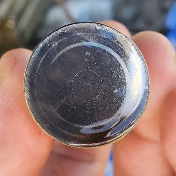

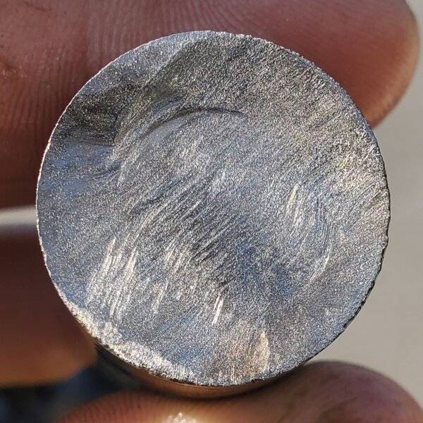

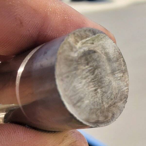

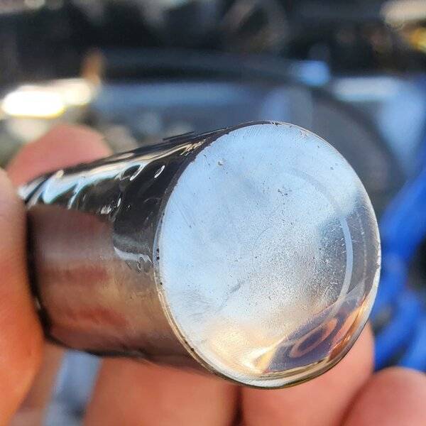

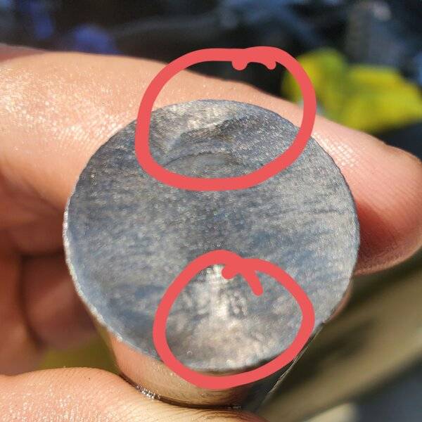

So I went ahead and pulled all the lifters on the passenger side since that is where I was hearing the noise.
1 lifter had me concerned. All other lifters looked the same. So I'm going to replace this lifter. Should I just replace all of them? Will replacing just the one lifter be detrimental? Is this a sign of a deeper problem I need to address?
Thank you all for your time and patience
I have attached photos of said lifters.
View attachment 1157866 View attachment 1157867 View attachment 1157868 View attachment 1157869 View attachment 1157870

I've had the car a little under a year. Don't know really any history on it. Unknown mile since it's non number matching. First Oil change was penzoil 10 30 second and third I used royal purpleA little history on your engine? Which cam? How many miles? What oil have you been using? The cam, more than likely, has been compromised by the look of those lifters.
Uh oh. Unfortunately no.. I didn't use a zinc additive.Any zinc additive?
DING DING DINGCam is toast.... Put a fork in it...
