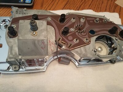

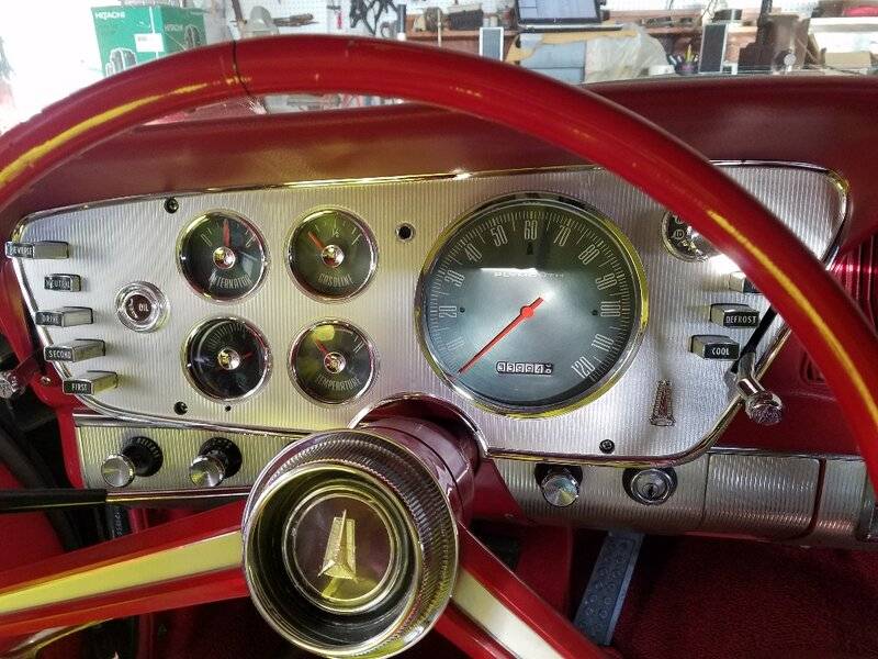

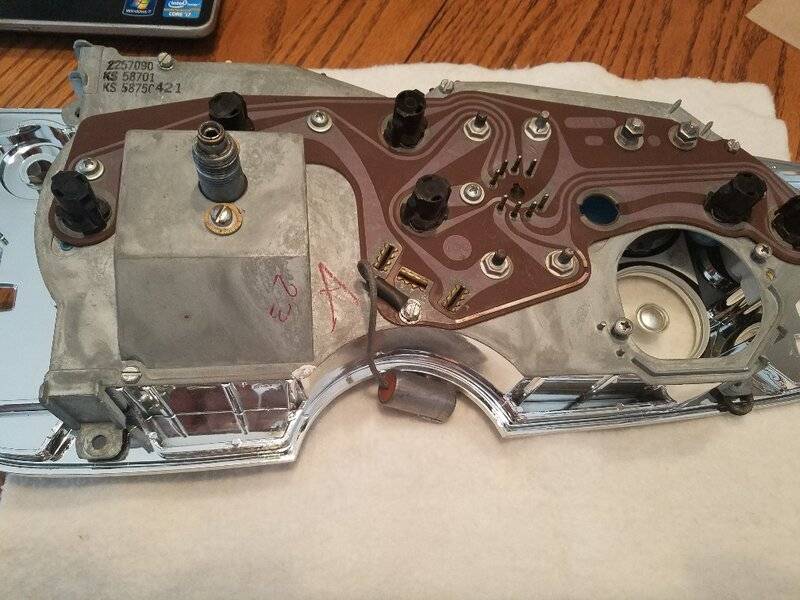

While not the same car, on my ’63 adding an aftermarket tach was pretty easy. I located one having about the same face diameter for the cluster lens and used duct tape to increase the diameter of the gauge housing to insert tightly in the space where the clock was. In my case, the clock had a cup enclosure and it sets in a tunnel so to speak in the assembly the circuit board as can see in the photo. As for the face of the tach, yep, it’s different from the OEM gauges; but wasn’t a concern with me for matching. Was no factory tach available in my car anyway. Only thing I’d prefer is a larger diameter given the size of the gauge faces; but that was what it was if wanting to use the clock space for a tach. Not sure what the cluster bezel rear configuration is on your car; but if you haven’t removed it yet, you may find some quick ideas when you can stare at it for a bit and looking up available tachs in the size needed and making a bracket as posted. If repro's are available…as posted, that’d be my 1st choice. I'd have liked to have that option.

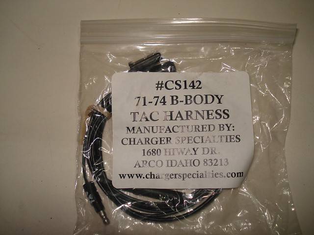

Charger specialties even offered once a Tic-toc-tach version for our cars. It seems didn't get success. I could have got one of those, but it was pricey

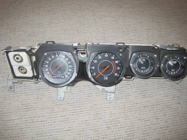

I had an Actron tach in my 70 Bee.
Fit well and the number fonts were close in style to the other gauges.
I did have to hack just a little to get it secured, and I removed the tach's clear plastic to cut down on the glare, which meant I had to fabricate a block off disk to go over the center.
Not a terribly hard project and turned out well.

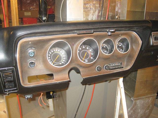

You can absolutely do the same thing with the 71-74 rallye dash.
The clock comes out whole and leaves a nice, big opening to work with.
As noted above, finding one that "fits in" both size wise and font wise, is the real challenge.

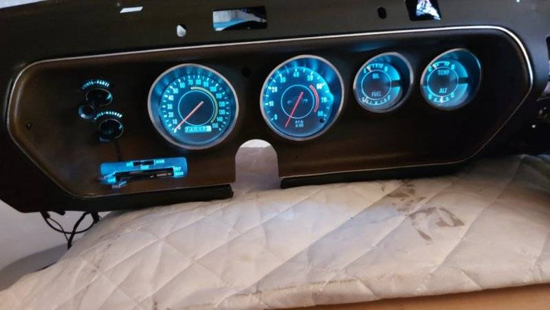

Did it on my 72.
Installed a new tachometer from Charger Specialties in place of the clock, also changed the lens to one without the hole for the clock thingy.
