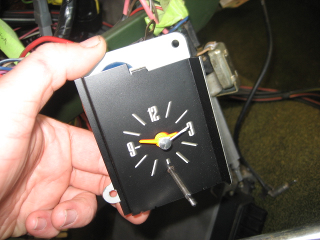

When I took my dash apart the clock wire was unpluged. Did some checking and the wire that was disconnected was the ground wire. I put the test light on the clock and the clock light works. When I connect the wire to the clock and check the it with test light the test light lights up. The clock still does not work. Is there something I'm missing or is clock bad Where would would I get one Thanks

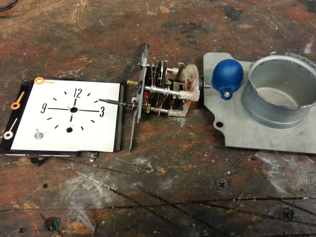

The clock is apart the bottom point contact is burnt off. The contacts won't even touch each other There is also a plastic gear that isn't pinned to anything

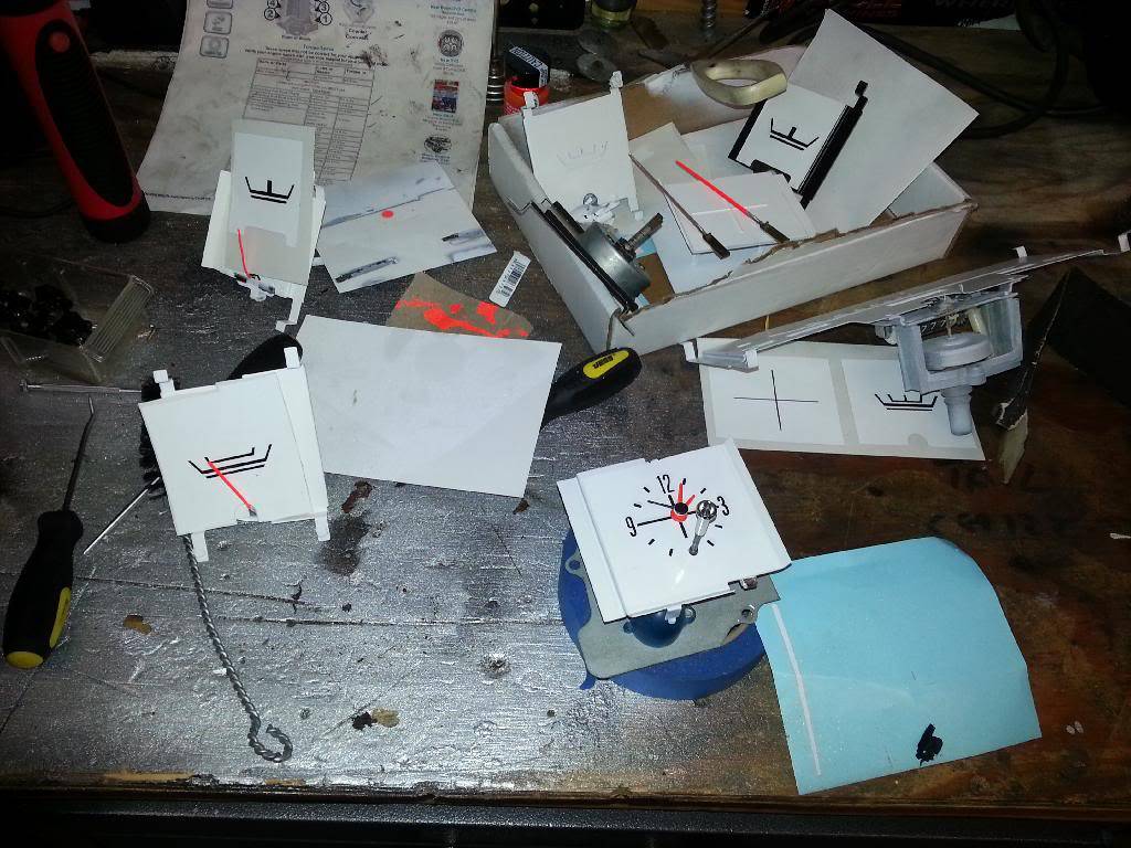

I replaced my original movement with a quartz movement and it works great. It looks completely original from the face side.
Ordered quartz conversion. People want a reduclious ammount of money on Fleabay for these clocks

Clock is mechanical, not electric... Power is just to wind the springs ( with a short in a points setup ) in it and make to work the mechanicals.
of course if you already took it appart and found burnt the points thats the problem LOL

The red power wire going to the voltage reducer on the guages has power. When I would put touch it to the clock frame with my test light the clock light would light up. When I would hook my test light to ground and touch the grey wire the test light wouldn't light up. But if I would hookup my test light to power and touch the grey wire it would light up. So I was assuming the grey wire was ground. Somebody was in the dash way before me grey wire had tape on it said clock but wasn't connected
Never spray wd40 in your clock it may run for a few but the lube ends up ruining the clock movement. as you saw the contact points were burned that is the most common issue and unless there is enough to save switching to the quartz is the best solution. I have done this twice now on non standard clocks, getting pretty good at it too.
The quartz conversion in mine is still going strong. When you get the kit be careful and follow the directions closely it is very easy to do. Be careful with the adjustment handle and new gear as it is not as solid as the original and will strip out if you put too much force on it. Also just a heads up most stems or chrome adjustment knob / handle whatever you want to call it get old and stripped, they are very cheap right now and this is a perfect time to replace them. O n fleabay for around $10
I know you are talking about 71-74 clocks but they are the same except size / shape just sharing a little lesson learned. Good luck!

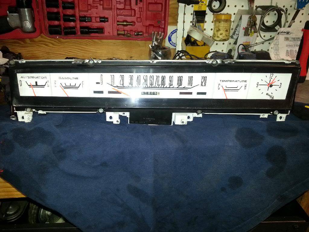

Where did you get the white face clock from It will go good with my cluster
white gauges sells the kit, however it seems not the clock face, just the blank space. I asked through the ebay store if they make the clock.
