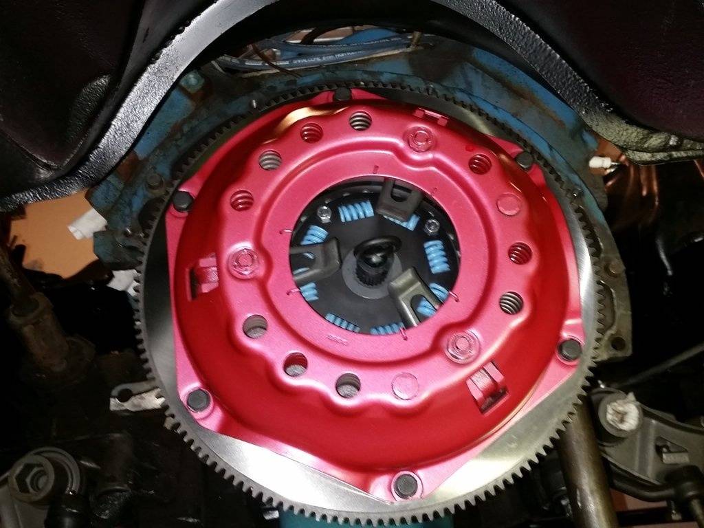

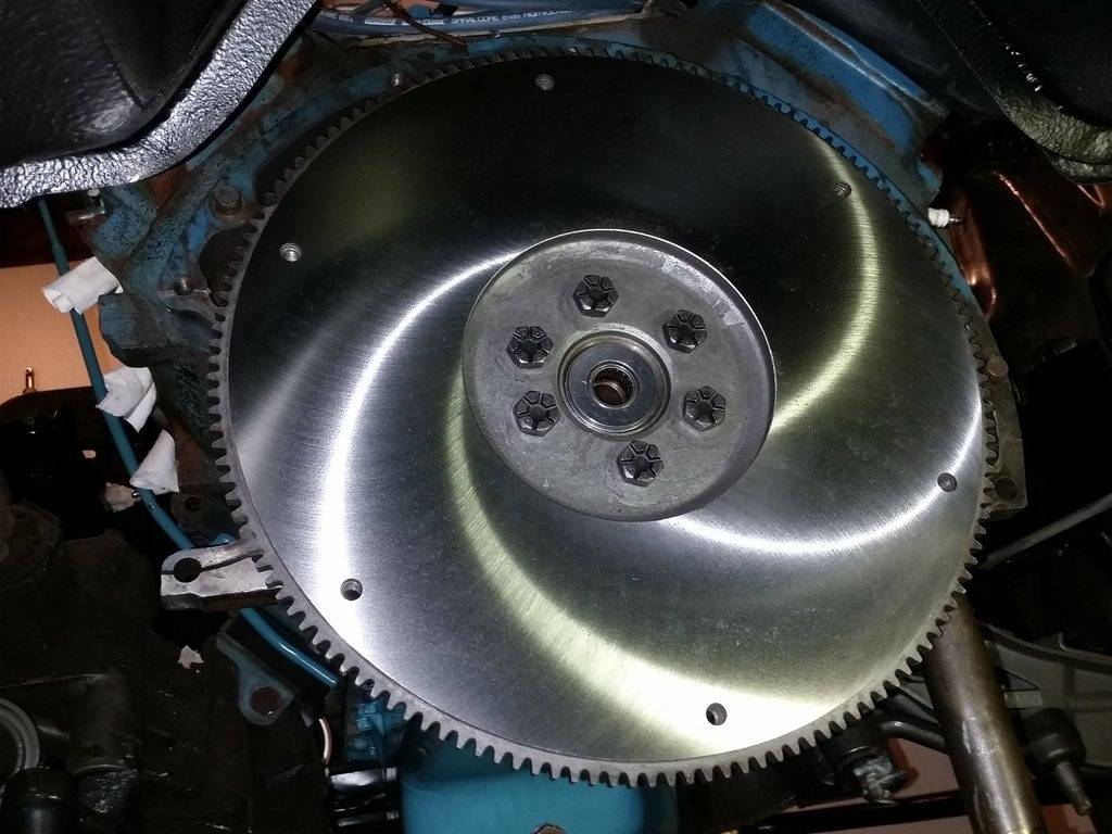

Not ready to drive yet.... Trans went in yesterday
So I just wanted to add the RAM clutch kit hooks up nice. Car smokes the 60s in 2nd and gets side ways with ease. @ 2800lbs it takes more pressure than I would have liked for everyday driving, but I don't drive my car everyday so not a show stopper. Seems like it wants to grab a bit faster than my Hays street/strip or maybe because the Hays was 30 years old and soaked with oil. It was a long time ago and I don't remember what is was like when it was new, Anyway big improvement.
