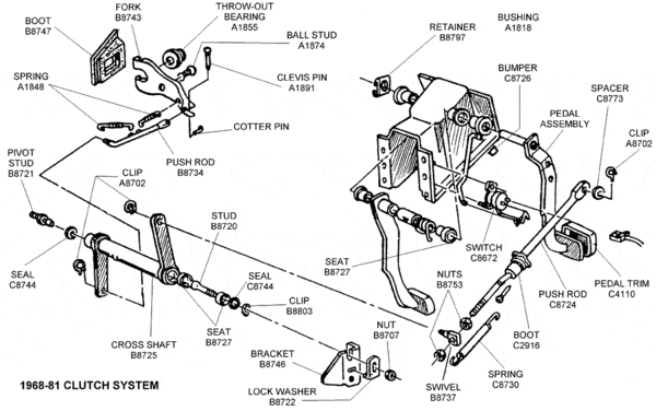

Hey guys I need opinions on the best way to install this linkage to get the easiest push. In your answer give me the hole number of the pedal, then short arm on the crank,. then the long arm on the crank! THANKS!!!!!!LK

3, 2, 1 It's basically a series of levers...longer pedal movement, but less force needed
1 on the pedal, 2 on the short arm, 1 on the long arm = the easiest push
You want the most leverage at the pedal - that's hole 1
Then you want the most leverage on the bellcrank - that's hole 2
Then you want the most leverage at the other end - that's hole 1
