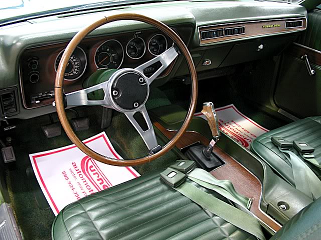

I am looking into swapping an A-833 into a 74 Roadrunner with a 727. What years of pedal should i look for. Are they the same 71 to 74 or are there any differences through the years?
My 71 ssp was an auto ,, i took the clutch an brake peddles out of a 73 rr , they fit right in
