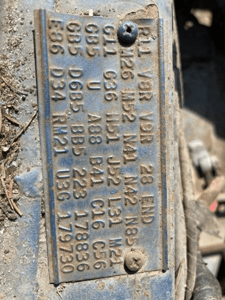

B5 blue with red stripes, anyone have one or pictures?
E86 440-4 Super Commando Only available as part of the GTX Pkg
D34 727 TF
RM Roadrunner
21 2 Dr Sedan
U 440-4 Super Commando
3 1973
G St Louis
179730 Sequence Number
GB5 Bright Blue Metallic New Color starting in 1971 not the EB5 from 1969
D6 Deluxe Bucket Seats
B5 Medium Blue
BB5 Medium Blue Door Panel
223 February 23rd SPD
178836 Vehicle Order Number
GB5 Bright Blue Metallic Roof Paint
U USA
A88 Interior Decor Pkg
B41 Frt Disc Brakes 10" Rear Drums
C16 Console
C56 ?
G11 Tinted Glass
G36 Painted Racing Mirrors
H51 A/C
J52 Inside Hood Release
L31 Fender Mount Turn Signal Indicators
M21 Drip Ral Moldings
M26 Wheel Lip Moldings
M52 ? M51 is power Sunroof M52 might be Manual?
N41 Dual Exhaust
N42 Chrome Tips
N85 Tachometer
R11 AM Radio 2 watt
V8R Sport Stripe Transverse Tape Red
V9R Sport Stripes Longitudinal Tape Red
28 28" Radiator
End End of Codes
thanks!! I don't have my list of options in front of me but I'm pretty sure this car has a few other options that didn't make the tag but this is a very good start. Yes, it's a manual sunroof, my understanding is they all were by 73 due to issues with the power versions of earlier years. It's a am fm stereo and it does have a tach also off the top of my head. When I get back around my list of options I will update
The R11 means it started life with an AM Radio... R35 is AM/FM... The radio may have gotten swapped along the way...
I seem to remember wondering about that when I 1st bought it, it's definitely a factory 73 radio. When you see the car, it's very obvious it was never restored or modified but it very possibly did have a miss order and the dealer installed a fm when new.
Common thing to dealer upgrade out of the dealer accessories catalog. Rear defogger, luggage rack, clock, tack, A/C, P/S, P/B..
One thing I'm curious about and maybe someone would have an answer, what cooling fan would this car have come with? Would the 28" radiator be considered heavy duty cooling and get a specific fan blade and clutch assembly? One other item I don't believe was on the fender tag is the 8 3/4 rear with the sure grip. I think this should have been a 2 tag car, I think I remeber others speaking in the past about cars that came with options not listed, is this a thing? I will look for the build/broadcast sheets to verify what actually was installed as I believe there were a few other options not listed. This car has not been molested, still has original exhaust even
A/C cars go HD cooling. You'd have to look up in the 73 parts book or maybe a galen book for the fan blade and clutch part numbers. Those usually have ink stamped p/n's.
would this information also be on the broadcast sheet?
