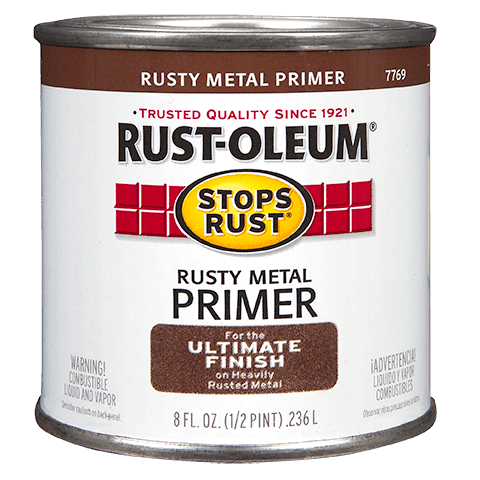

On a project cars if I have an area I don't clean the rust off, or if I can't clean it, I've had good results with this keeping the rust from coming back.
I'm just not a fan of "coating" anyway.
I've sprayed it in inside rocker panels, frame rails and cowls.
Areas I can't reach.
If you are going to paint over it with auto paint, just do a coat of lacquer primer over the Rustoleum.
Really, what ever works for your particular situation.
Rad thanks, yes I am planning to paint it the body color eventually. I think I’ll try and clean the rust off the areas then hit it with the rustoleum. Or POR15. Rustoleum might be better since it’s going to be painted?
I would sand it ,hit it with por -15 and then leave it until the body work and paint is done. That way if they have to work the metal from the back side all they would do is maybe scratch the por -15 . Top coat with whatever when it's out of body & paint.
