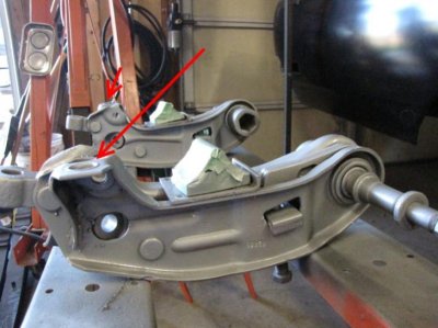

I will be installing '70 b-body lower control arms on my '66 Satellite. So I haven't been out and about for quite some time to see a comparison. Could somebody please post a pic of the '70 sway bar mounting points? Thanks, Steve
Red arrows pointing at sway bar mount points....
Thanks for your reply. My replacement lower control arms have the sway bar end point mounts in the middle. It's the k-member mounting point area of a '70 to '72 b-body that I need a pic of. I apologize for the confusion. Thanks, Steve

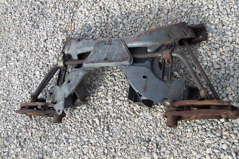

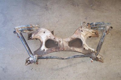

Here are the setups. Don't think you can fit a 70 swaybar on a 66 K-frame.
Top is 70-72
Bottom is 66-69

Thanks for the pics, guys. Well, now I can see that I might not be able to use the '70 lower control arms as planned. The sway bar mounting tab on the '70 LCA would be to close to the '66 k-frame. The leverage resistance of the older sway bar would be less effective than the shorter '70 style LCA. But then again you have the leverage of the '70 LCA playing against the sway bar because of it's mounting tab. Your opinions are welcome.
I'm back in the hunt for a pair of '66-'69 LCA's again. Thanks for the help, Steve
